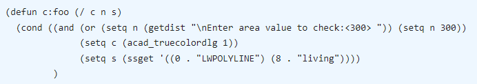

  1. Give this a try: (defun c:foo (/ c n s) (cond ((and (or (setq n (getdist "\nEnter area value to check:<300> ")) (setq n 300)) (setq c (acad_truecolordlg 1)) (setq s (ssget '((0 . "LWPOLYLINE") (8 . "living")))) ) (foreach e (vl-remove-if 'listp (mapcar 'cadr (ssnamex s))) (if (>= (vlax-curve-getarea e) n) (entmod (append (entget e) c)) (ssdel e s) ) ) (sssetfirst nil s) ) ) (princ) )
    2 points

  3. just fyi Ron your code ask for an area but then only uses 300 to check instead of n. (if (>= (vlax-curve-getarea e) 300.)
    1 point
