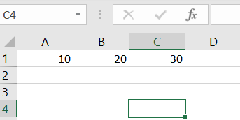

  5. Ok had a play and you can just pass a value into a cell using a direct method of Autocad/Bricscad talking to excel. No Csv. So I put 10 in A1 20 in B1 then did (putcell "C1 "=A1+B1") the result as required. If you get a copy of getexcel.lsp it has a putcell function. I used my own version of a excel.lsp program. This is the very cut down version but worked. The full code does much more options like pick a excel file etc. (defun putcell (cellname val1 / ) (setq myRange (vlax-get-property (vlax-get-property myxl "ActiveSheet") "Range" cellname)) (vlax-put-property myRange 'Value2 val1) ) ; have excel already open (or (setq myxl (vlax-get-object "Excel.Application")) (setq myxl (vlax-get-or-create-object "excel.Application")) ) (vla-put-visible myXL :vlax-true) (vlax-put-property myxl 'ScreenUpdating :vlax-true) (vlax-put-property myXL 'DisplayAlerts :vlax-true) ; putcell example (putcell "C1" "=A1+B1")
