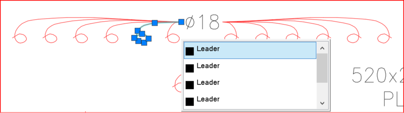

  7. @mhupp to the rescue, and spot on, as usual. I enjoyed reading the link too, thanks. FYI, in case you don't already know. As in the following screenshot. Should you have Selection Cycling enabled... My selection is ambiguous because of the overlapping leaders within my pick box. The display of those grips on that second leader means that the software is guessing, that is probably the one you intend to select, and it is shown blued out at the top of the list. Should that in fact, be correct, and your intended selection, just hit ENTER and it will be one selected. The presumptive selection will be at the top of the list and filled with blue. Should that not be the one you meant, as you click on other objects displayed on the list, that objects grips will be highlighted.

  9. I think that is letting you know about selection cycling. Turn it off with (setvar 'SELECTIONCYCLING 0)
