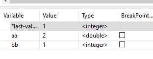

  6. Might be different in other software but in BricsCAD yes. you can always test with (type variable) (defun C:test (/ aa bb) (setvar 'textsize 2) (setq aa (getvar "TEXTSIZE")) ;; aa is a real number? (setq bb (getvar "cmdecho")) ;; bb is int (prompt "\naa is ") (princ (type aa)) (prompt "\nbb is ") (princ (type bb)) )
    1 point
  7. so is this correct? (setq aa (getvar "TEXTSIZE")) ;; aa is a real number? (setq bb (getvar "cmdecho")) ;; bb is int?
    1 point
  8. (setq x "100") ;string (setq x 100) ;integer (setq x 100.0) ;double or real number math with two integers will only produce an integer (/ 3 2) = 1 math with an integer and real will produce a real number (/ 3 2.0) = 1.5 Why I called it double 2. Most system variables are stored as real numbers it just depends on what variable it is. like cmdecho is either 1 or 0 on/off so that is just an integer. but textsize is stored as a real number.
    1 point
  9. One minor thing. (setq globalvar_ht (atof "1")) = (setq globalvar_ht 1) Also wouldn't hurt to put a decimal point on the variables with numbers especially if your going to use them in calculations. (setq globalvar_ht 1.0) Example: (defun C:test (/ x) (setq x 100) ;integer (setq x (/ x 6)) (princ x) (prompt (strcat "\n" (rtos x 2 5) "\n")) (setq x 100.0) ;double (setq x (/ x 6)) (princ x) (princ) )
