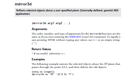

  7. You can simply use (mirror3d) function as a part of (geom3d.arx) extension for lisp... This picture is from documentation...
    1 point
