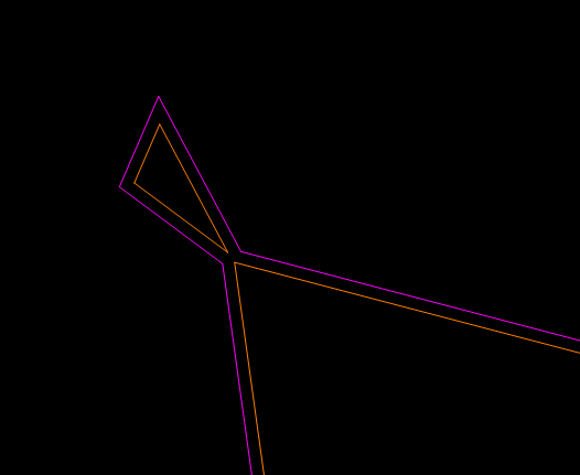

  4. Their is alot more to offset command. have to check the polyline's direction. (is it clockwise or counter clock wise) then the vla-offset its self is a variant (because their can be multiple offsets) unless you use vlax-invoke then its a list. you shouldn't have multiple offsets unless you have weird shape that has a choke point like this. example creates two new polylines. I test for this in my lisp so it will alert with a popup saying "More Than one Offset Detected" and quit. but this should never happen. (defun c:Fence_Update (/ i obj1 obj2 ent off blug) (vla-startundomark (vla-get-activedocument (vlax-get-acad-object))) (setq i 0) ;; parameter index (setq obj1 (vlax-ename->vla-object (car (entsel "\nSource Polyline: "))) obj2 (vlax-ename->vla-object (car (entsel "\nFence Polyline: "))) ) (setq off (vlax-invoke obj1 'offset (if (CW obj1) 2.0 -2.0))) ;offset to inside (if (<= (length off) 1) (setq bulg (mapcar 'cdr (vl-remove-if-not '(lambda (x)(= (car x) 42)) (entget (vlax-vla-object->ename (setq off (car off))))))) (progn (alert "\nMore Than one Offset Detected") (quit) ) ) (vla-put-Coordinates obj2 (vla-get-Coordinates off)) (foreach b bulg (vla-setbulge obj2 i (nth i bulg)) (setq i (1+ i)) ) (vla-delete off) (vla-endundomark Drawing) (princ) ) ;;----------------------------------------------------------------------------;; ; Check Polylines direction is CW or CCW - Writer Evgeniy Elpanov By Bill Gilliss ;(vla-offset (vlax-ename->vla-object ent) (if (CW ent) -0.01 0.01)) (defun CW (poly / lw lst LL UR) (if (= (type poly) "ENAME") (setq lw (vlax-ename->vla-object poly)) (setq lw poly) ) (vla-GetBoundingBox lw 'LL 'UR) (setq LL (vlax-safearray->list LL) UR (vlax-safearray->list UR) lst (mapcar (function (lambda (x) (vlax-curve-getParamAtPoint poly (vlax-curve-getClosestPointTo poly x) ) ) ) (list LL (list (car LL) (cadr UR)) UR (list (car UR) (cadr LL)) ) ) ) (if (or (<= (car lst) (cadr lst) (caddr lst) (cadddr lst)) (<= (cadr lst) (caddr lst) (cadddr lst) (car lst)) (<= (caddr lst) (cadddr lst) (car lst) (cadr lst)) (<= (cadddr lst) (car lst) (cadr lst) (caddr lst)) ) ;_ or t ) )
