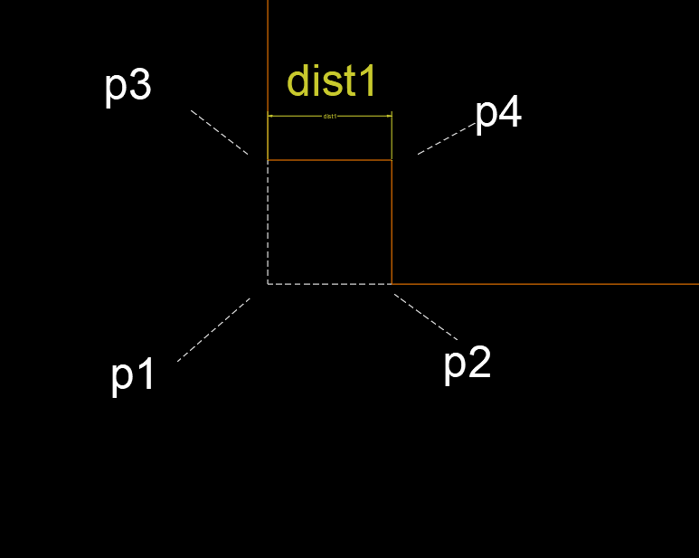

  3. I made something that I quite like. It works on your dwg example. It could use some work to make it more versatile. - The code works only for polylines. - Only for horizontal/vertical lines. - There's hardly any error check. Use it as intended, or I don't know what will happen. Command CCF - user sets a distace dist1 - user selects the polyline - Now pick corner points p1. don't pick the end of the polyline. It only expects corner points (best put on OSNAP) - p1 now gets replaced by p2 p4 p3 I haven't looked well at the other replies. I'll just assume I did it a little different (vl-load-com) ;; returns a list of coordinates. But we replace 1 coordinate by 3 points (defun move_vertex_add_custom_chamfer ( lst ind p1 p2 p3 / new_lst i) (setq new_lst (list)) (setq i 0) (repeat (/ (length lst) 2) (if (= i (* 2 ind)) ;; add the 3 points (setq new_lst (append new_lst (list (nth 0 p1) (nth 1 p1) (nth 0 p2) (nth 1 p2) (nth 0 p3) (nth 1 p3) ))) ;; copy list (setq new_lst (append new_lst (list (nth i lst) (nth (+ i 1) lst) ))) ) (setq i (+ i 2)) ) new_lst ) ;; CCF for Custom ChamFer (defun c:ccf ( / dist dist2 pline p1 param1 d1 p2 p3 ang1 ang2 coords) ;; User enters the distance / offset (setq dist (getdist "\nDistance to custom chamfer: ")) ;; user selects polyline. (setq pline (car (entsel "\nSelect polyline: "))) (while (setq p1 (osnap (getpoint "\nSelect corner point: ") "_end")) ;; select corner (setq param1 (vlax-curve-getParamAtPoint pline p1)) ;; d1 = the distance along the path of the polyline at p1 (setq d1 (vlax-curve-getDistAtPoint pline p1)) ;; now p2 = d1 + offset distance, p1 = d1 - offset distance, (setq p2 (vlax-curve-getPointAtDist pline (- d1 dist) )) (setq p3 (vlax-curve-getPointAtDist pline (+ d1 dist) )) ;;;; now check the angles. ;;;; angle from previous endpoint to p1 ;;(setq ang1 (angle ;; (vlax-curve-getPointAtParam pline (- param1 1)) ;; (vlax-curve-getPointAtParam pline param1) ;;)) ;; ;; ;; angle from p1 to newt endpoint ;;(setq ang2 (angle ;; (vlax-curve-getPointAtParam pline (+ param1 1)) ;; (vlax-curve-getPointAtParam pline param1) ;;)) ;; TODO: make this work for other angles; not just horizontal/vertical ;; We look for p4, which cas 1 coordinate of p2 and 1 of p3 (if (= (nth 0 p1) (nth 0 p2) ) ;; p1-p2 is horizontal, so we take y-value of p2 and x-value of p3 (setq p4 (list (nth 0 p3) (nth 1 p2) )) ;; else the opposite (setq p4 (list (nth 0 p2) (nth 1 p3) )) ) ;; read vertex coordinates; replace the selected point. (setq coords (vlax-get (vlax-ename->vla-object pline) 'coordinates)) ;; Remove the chosen point, replace it by the 3 "chamfered" points (setq new_coords (move_vertex_add_custom_chamfer coords param1 p2 p4 p3)) (vlax-put (vlax-ename->vla-object pline) 'coordinates new_coords) ;replace the coordinate list ) )
    2 points
  4. thank you all for your help! i got all your lisp and will use it depending on what the drawing is presented to me, polyline or line. it's really close to what i wanted and can work as intended. and i am already happy with what you guys gave me. PS: but for expert LISP writers out there here's the more detailed explanation on how i wanted the command SUMMARY: A custom command just like chamfer or fillet that does a "notch" instead of an arc (for fillet) or a diagonal (for chamfer) Details: can work on lines or polylines case 1 if objects is short to the intersection it extends it up to the notch case 2 if objects is longer than the intersection it trims it up to the notch case 3 if lines meet at intersection it creates the notch case 4 if objects are lines everything are created as lines (just like chamfer would do) case 5 if one object is polyline it joins objects into the polyline (just like chamfer would do) case 6 in case 0 distance is used it will extend or trim the line to meet at intersection (just like fillet and chamfer) Procedure: type in command type in distance / use previous distance (distance is recorded in case of multiple uses (just like chamfer do) pick object 1 pick object 2 end.
