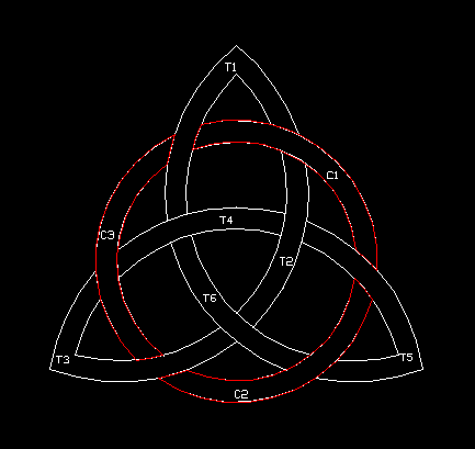

  8. So you made lots of circles offset and trimmed. If you want each shape to be individual change to another layer and use BPOLY command this will make new plines as a shape representing the 2 arcs but with ends. Just pick a point inside the 2 arcs.
