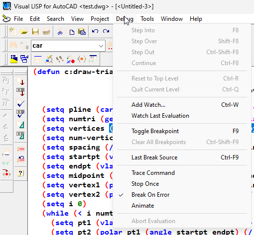

  4. The first step to becoming a proficient programmer is learning how to debug code. Open up the VLIDE and set break on error. Then load the selection: There are a couple of issues with line 3: (setq vertices (vlax-invoke pline 'vertices)) vlax-invoke requires a VLA-OBJECT (vlax-ename->vla-object pline) and a polyline does not have a vertices property, it's coordinates. Here is a common way to get LWPOLYLINE coordinates (mapcar 'cdr (vl-remove-if '(lambda (x) (/= 10 (car x))) (entget pline))) This returns ((X Y) (X Y) (X Y) (X Y)) Another way is like this which works on "heavy" polylines as well: (vlax-get (vlax-ename->vla-object pline) 'coordinates) This returns (X Y X Y X Y X Y) It does not look like you're using the vertices variable for anything except setting the num-vertices variable ? An easier way to get that number is through the 90 DXF code. (cdr (assoc 90 (entget pline)))
