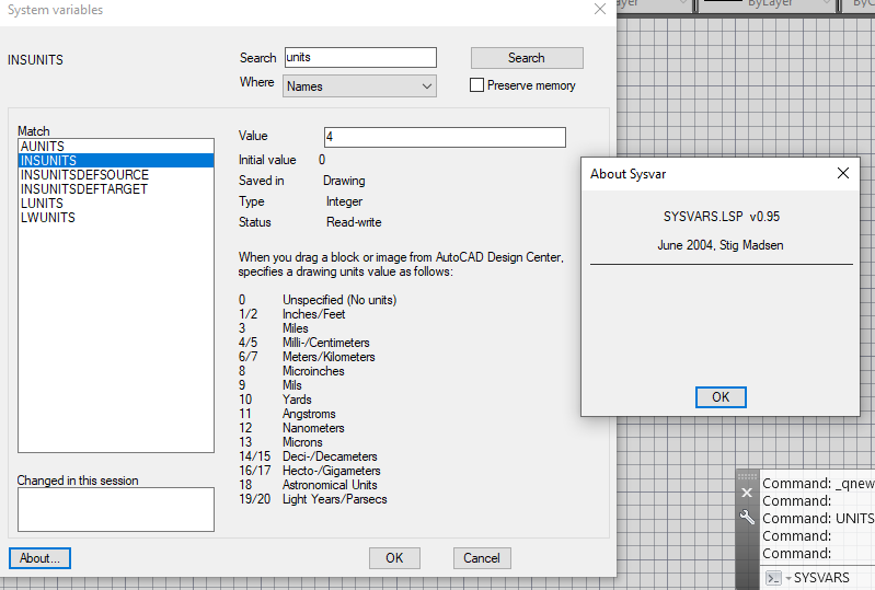

  6. find attached , STIG MADSEN SYSVARS sysvar-2006.rar
    1 point
  7. Please dig at INSUNITS system variable , as you will note , 4 for mm or 5 for meter , and 1 for inch , and 2 for feet , so read by (setq insunits (getvar 'insunits)) And change to (setvar 'insunits 4 ) to mm or (setvar 'insunits 5 ) to meter and before send (setvar 'insunits 2 ) to feet And at last and not least , save dwg with some postfix to denote which insunits the are.
    1 point
