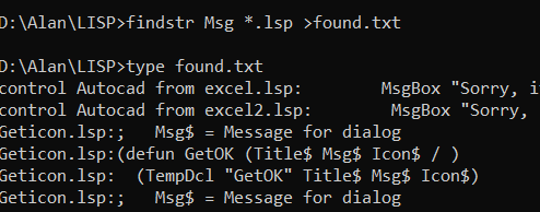

  6. This is like "FINDSTR" a windows function so find "Aliasedit" on my PC it can search an entire disk, just takes a while. I use to find code I have done. So maybe an option put in guess "Ali" Findstr works with this. Like others around 3000 lisp files.
