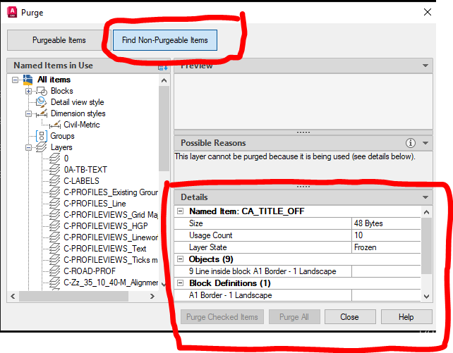

  2. I have a LISP Routine that I found on here that sets all objects within blocks in the drawing to layer 0 then i purge out those layers. (defun c:norm (/ *error* adoc lst_layer func_restore-layers) (defun *error* (msg) (func_restore-layers) (vla-endundomark adoc) (princ msg) (princ) ) ;_ end of defun (defun func_restore-layers () (foreach item lst_layer (vla-put-lock (car item) (cdr (assoc "lock" (cdr item)))) (vl-catch-all-apply '(lambda () (vla-put-freeze (car item) (cdr (assoc "freeze" (cdr item))) ) ;_ end of vla-put-freeze ) ;_ end of lambda ) ;_ end of vl-catch-all-apply ) ;_ end of foreach ) ;_ end of defun (vl-load-com) (vla-startundomark (setq adoc (vla-get-activedocument (vlax-get-acad-object))) ) ;_ end of vla-startundomark (if (and (not (vl-catch-all-error-p (setq selset (vl-catch-all-apply (function (lambda () (ssget '((0 . "INSERT"))) ) ;_ end of lambda ) ;_ end of function ) ;_ end of vl-catch-all-apply ) ;_ end of setq ) ;_ end of vl-catch-all-error-p ) ;_ end of not selset ) ;_ end of and (progn (vlax-for item (vla-get-layers adoc) (setq lst_layer (cons (list item (cons "lock" (vla-get-lock item)) (cons "freeze" (vla-get-freeze item)) ) ;_ end of list lst_layer ) ;_ end of cons ) ;_ end of setq (vla-put-lock item :vlax-false) (vl-catch-all-apply '(lambda () (vla-put-freeze item :vlax-false)) ) ;_ end of vl-catch-all-apply ) ;_ end of vlax-for (foreach blk_def (mapcar (function (lambda (x) (vla-item (vla-get-blocks adoc) x) ) ;_ end of lambda ) ;_ end of function ((lambda (/ res) (foreach item (mapcar (function (lambda (x) (vla-get-name (vlax-ename->vla-object x) ) ;_ end of vla-get-name ) ;_ end of lambda ) ;_ end of function ((lambda (/ tab item) (repeat (setq tab nil item (sslength selset) ) ;_ end setq (setq tab (cons (ssname selset (setq item (1- item)) ) ;_ end of ssname tab ) ;_ end of cons ) ;_ end of setq ) ;_ end of repeat tab ) ;_ end of lambda ) ) ;_ end of mapcar (if (not (member item res)) (setq res (cons item res)) ) ;_ end of if ) ;_ end of foreach (reverse res) ) ;_ end of lambda ) ) ;_ end of mapcar (vlax-for ent blk_def (vla-put-layer ent "0") (vla-put-color ent 0) (vla-put-lineweight ent aclnwtbyblock) (vla-put-linetype ent "byblock") ) ;_ end of vlax-for ) ;_ end of foreach (func_restore-layers) (vla-regen adoc acallviewports) ) ;_ end of progn ) ;_ end of if (vla-endundomark adoc) (princ) ) ;_ end of defun If that doesn't work you can run purge then at the top click onto "find Non-Purgeable Items" and in the details of the selected layer it should tell you if anything is still hiding on the layer you dont want and usually where to find it. hopefully this helps.
