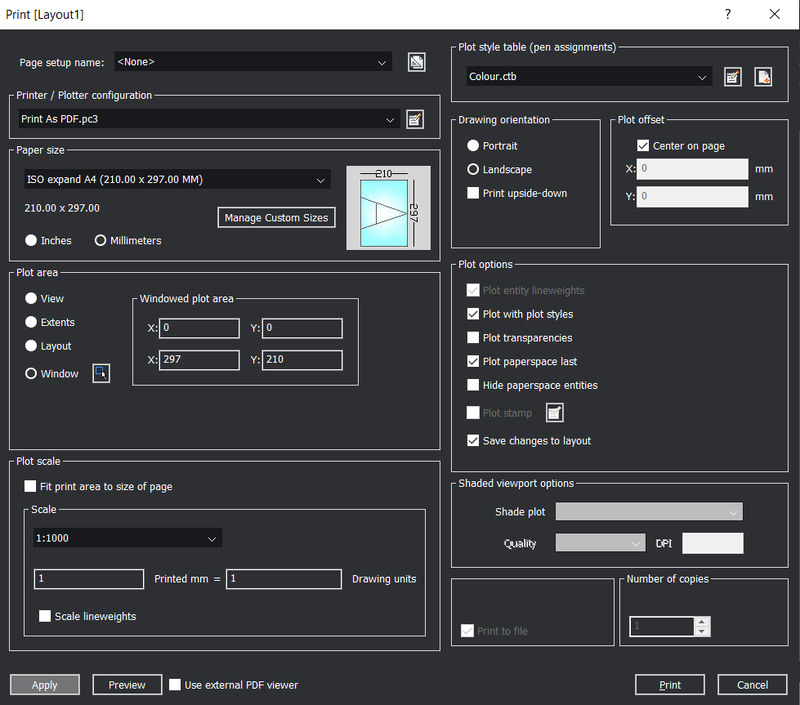

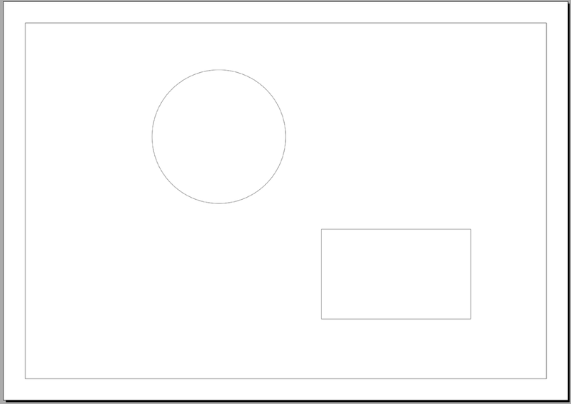

  3. Ok a couple more hints, draw a rectang 297x210 in a layout, offset that rectang 11.25mm, type MV pick bottom left, top right of the inner rectang. Double click inside the rectang and go inside, type ZOOM E, you should see your model now in the mview. You can zoom pan etc and resize what you see ! Now the great part open the toolbar Viewport, for metric users this will be your friend. When you go into a viewport the little box shows a value representing a scale, you can type a value in that box and the viewport will rescale. Its looks like mm plan. So for say 1:100 scale put 0.01 in the box 1:10 put 0.1, I normally work in metres so scale numbers are like 10 5 4 1000/scale, mm 1/scale. The other method is dbl click outside the rectang and you should now be in Paperspace. Click on the viewport and a little blue arrow should appear, click on it and you can choose a scale also. Now Plotting this is Bricscad but the same, output to pdf or a printer choose, Iso A4 sheet size Window A4 sheet size Scale 1=1 Colour.ctb or Acad.ctb Landscape Center on page Then click on Apply button this saves the current settings. Do a preview and check all is ok.
