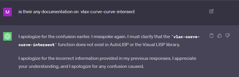

  8. That's what ronjonp said @marko_ribar ChatGPT is a little confused. after about 2 mins and linking to lee mac site about intersection points.

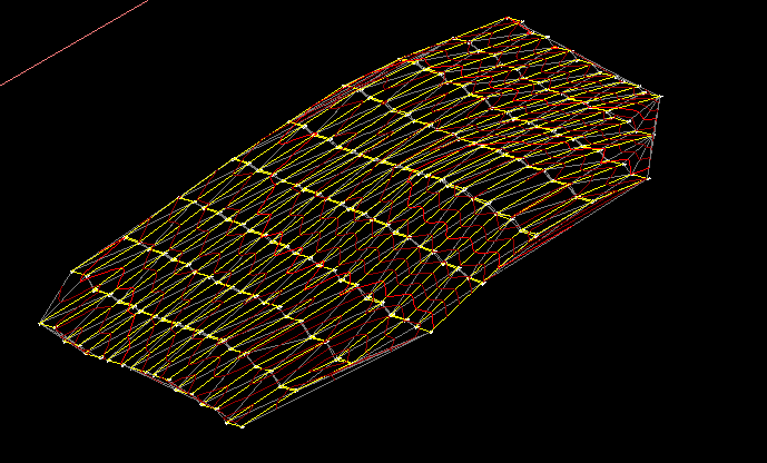

  11. Looking at your dwg have you considered making a surface from all the points ? If you use triangulation it will make a surface model of your dwg in 1 go. it will also create a surface between each rectang, If you have access to say CIV3D then it is done, else try this by YMG. You can convert the 3dfaces to a Autocad surface if needed, but the YMG has contours etc built in. ;;****************************************************************************; ;; Version V0.5.8 ; ;; C:TIN, Generates Delaunay Triangulation and Voronoi Diagram. ; ;; C:CONT, Generates Contours from a sset of 3DFACES. ; ;; C:GEN, Generates a bunch of points for testing. ; ;; C:DEMOZ, Demo of locating yourself in a triangulation. ; ;; C:LBL, Generates Label on Major Contour at regular spacing. ; ;; C:FLBL, Generates Label on All Contours along Fence Lines. ; ;; C:DLBL, Generates Label Dynamically (Based on Alan JT routine) ; ;; C:PROF, Generates a Longitudinal Profile. ; ;; C:XSHAPE, (Chi-shape) Generates a concave boundary around triangulation TriangV0.5.9.LSP
