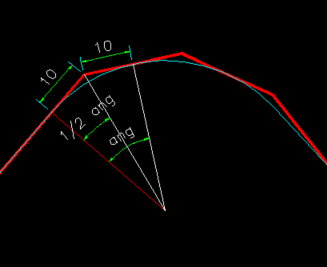

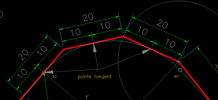

  13. @Huuthanh As I understand, the task to do is to draw a partial POLYGON, 20 units sides and 120 units length , following the original Polyline1 path.
    1 point

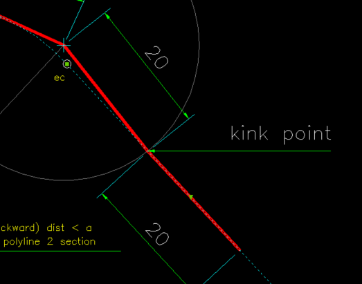

  14. On the right side you have a kink without an arc. Is that correct ? If you look at the formula for an arc & chord you can work out the tangent points, given a R radius. You have a 10-10 IP calc. Pythagoras and a/sin a=b/sin b=c/sin c so can work out angle by rearranging the sine formula, as one angle is 90 degrees, but hypotenuse has to be calculated.
    1 point
