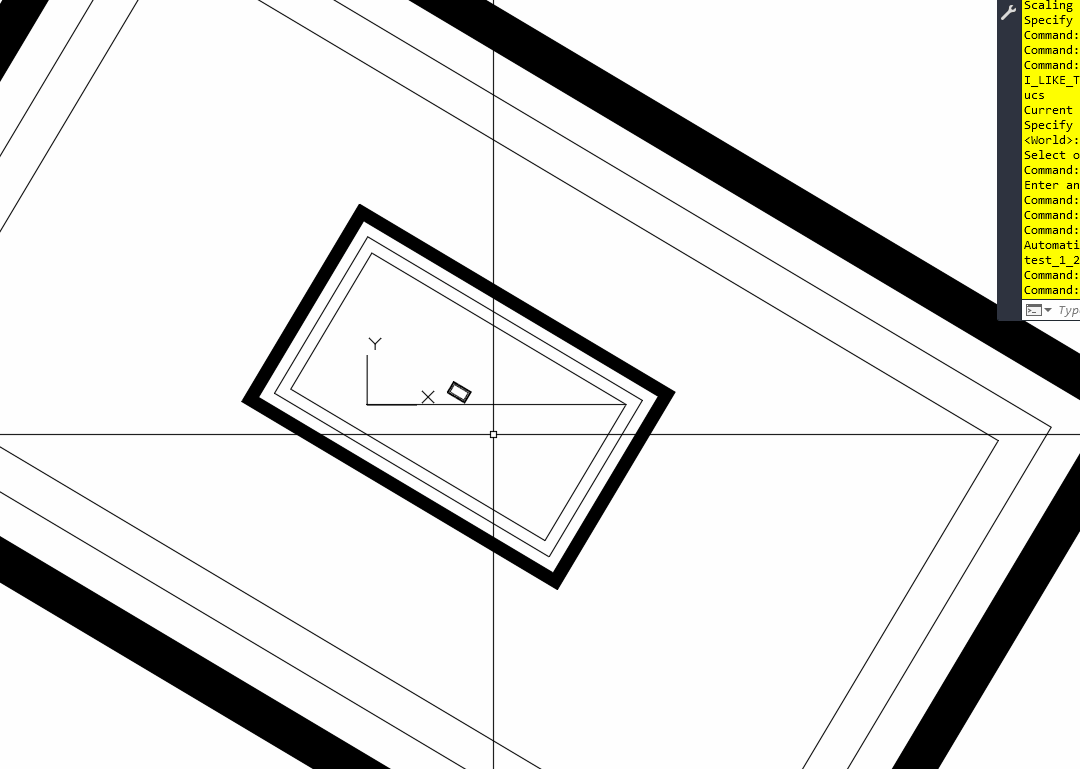

  3. Thanks, @marko_ribar and @Steven P. I like how the built-in UCS command handles a picked object. Depending on which side of a polyline or line segment you pick determines the orientation of the new UCS. So I came up with the idea of retrieving the previous window coordinates before the UCS command was issued. With help from a fn from Lee Mac of course. This gets it close enough to where I need to be after running the UCS command and not send me into outer space after running the plan command. GIF and code: ;; ;; Restores the zoomed in window after running the command "UCS" "_OB" followed by the plan command ;; Written on 2023.07.18 by 3dwannab ;; LM:ViewportExtents by Lee Mac (THANKS AGAIN) ;; (defun c:I_LIKE_TO_ZOOM_IT_ZOOM_IT (/ *error* acDoc LM:ViewportExtents pt1 pt2 vp_pts) (vl-load-com) ;; Viewport Extents - Lee Mac ;; Returns two WCS points describing the lower-left and ;; upper-right corners of the active viewport. (defun LM:ViewportExtents (/ c h v) (setq c (trans (getvar 'viewctr) 1 0) h (/ (getvar 'viewsize) 2.0) v (list (* h (apply '/ (getvar 'screensize))) h) ) (list (mapcar '- c v) (mapcar '+ c v)) ) (defun *error* (errmsg) (and acDoc (vla-EndUndoMark acDoc)) (and errmsg (not (wcmatch (strcase errmsg) "*CANCEL*,*EXIT*")) (princ (strcat "\n<< Error: " errmsg " >>\n")) ) ) (setq acDoc (vla-get-ActiveDocument (vlax-get-acad-object))) (or (vla-EndUndoMark acDoc) (vla-StartUndoMark acDoc)) (setq vp_pts (LM:ViewportExtents)) (command "ucs" "_OB" pause "plan" "") (setq pt1 (vlax-3d-point (car vp_pts))) (setq pt2 (vlax-3d-point (cadr vp_pts))) ; Restores the portion of the screen you were originally in (vla-ZoomWindow acadObj pt1 pt2) (vla-EndUndoMark acDoc) (*error* nil) (princ) ) (c:I_LIKE_TO_ZOOM_IT_ZOOM_IT)
