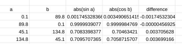

  7. Be careful of how "tol" is used in your program. Due to the slope of the sine function being close to 45 degrees near zero degrees compared to its slope near 90 degress (almost flat) you wil get more precision when angle "a" i,s closer to 0 degrees than when it's near 90 degrees. Your program should use sin(a) cos(b) for when a is < 45 and sin(b), cos(a) otherwise. In each of the following examples, the angle difference between a and b is 89.7 degrees. Note how the difference varies as a function of the angles used.
