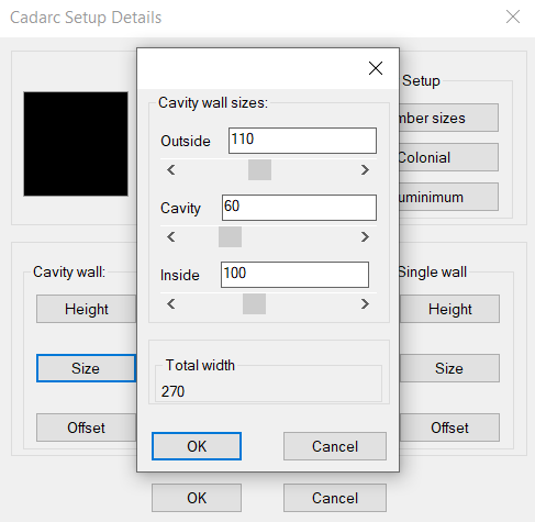

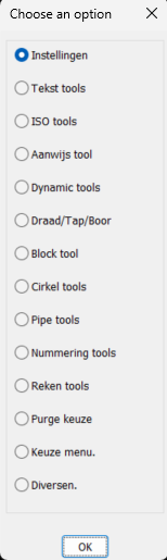

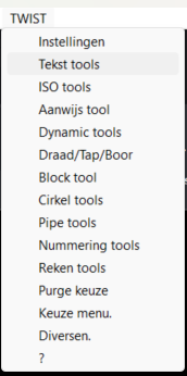

  2. Ran code, I still think way to cluttered. This shows the main menu looking at your dcl would have 14 main options then go to correct sub menu. ? add more. This is a custom menu way easier to make than a dcl. This is an alternative dcl method pick the type then a child dcl opens. This shows a child DCL over the main dcl menu choice "Size"
    1 point
