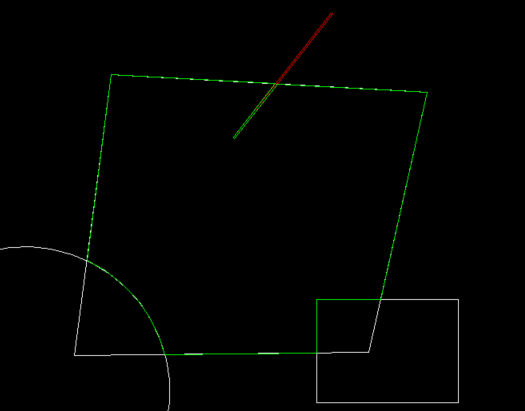

  5. Bpoly will do something close, to 1st image, note the single line sticking in will be ignored. The only way to make that work maybe is to make it a rectang with a width of 0.000000001
    1 point
