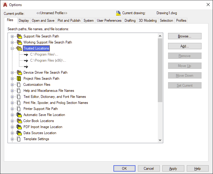

  3. I think I got it working. main_routine.lsp (I guess there is not need for loading adder function explicitly by (load "voithitiko.lsp") since it's being loaded when the .vlx starts) (defun c:santonis ( / ) (alert (strcat "sum=" (itoa (adder 6 1)))) ) and ;;; Visual LISP make file [V1.0] anter saved to:[C:/Users/antonisg/Dropbox/douleia/autolisp_grafeio/vlx_sense] at:[10/19/23] (PRV-DEF (:target . "anter.VLX") (:active-x . T) (:separate-namespace) (:protected . T) (:load-file-list (:lsp "voithitiko.lsp") (:lsp "main_routine.lsp") ) (:require-file-list) (:ob-directory) (:tmp-directory) (:optimization . st) ) ;; EOF all i did is changing the order of .lsp files at this tab

  4. voithitiko.lsp has to be in a folder trusted locations or support path when only calling it out by name (load "voithitiko.lsp") or use the full path (load "C:/Users/antonisg/Dropbox/douleia/autolisp_grafeio/voithitiko.lsp") --Edit https://help.autodesk.com/view/ACDLT/2024/ENU/?guid=GUID-F3639BAA-FD70-487C-AEB5-9E6096EC0255
