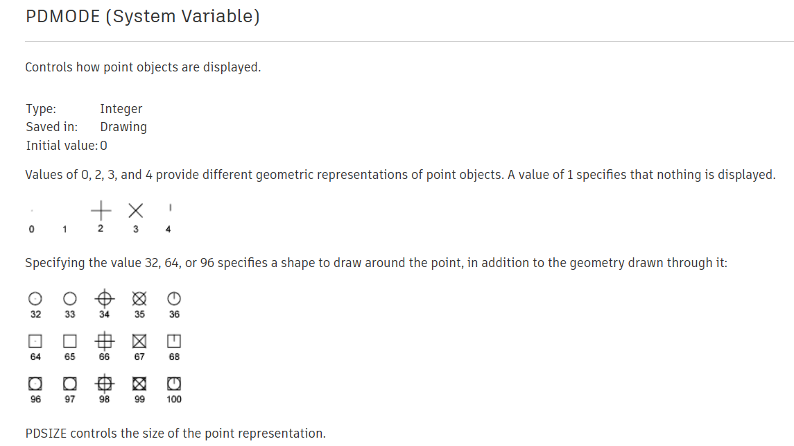

  9. I use pdmode all the time as just remember 1 number.
    1 point
  10. The centre of the polyline is marked by a point, I assume the circle is your point style? Use the command ptype to adjust the point style, your point can be relative (the size changes as you zoom) or absolute (it won't change, gets bigger or smaller as you zoom) - set it to absolute and it will stay the same
    1 point
