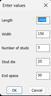

Multi GETVALS.lspHave a look at this it's a front end for your input. Save it to a support path. (if (not AH:getvalsm)(load "Multi Getvals.lsp")) (setq ans (AH:getvalsm (list "Enter values " "Length " 5 4 "1000" "Width " 5 4 "150" "Number of studs" 5 4 "5" "Stud dia" 5 4 "25" "End space" 5 4 "50" ))) (setq len (atof (nth 0 ans)) wid (atof (nth 1 ans)) num (atof (nth 2 ans)) dia (atof (nth 3 ans)) espc (atof (nth 4 ans)) )1 point
