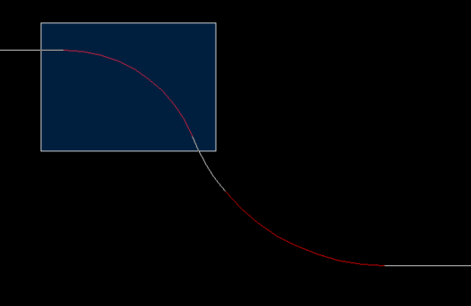

  2. A question for Bear, is the shape always ortho line work ie 0 90 180 270 with arcs. May be a real quick solution.
    1 point
  3. Maybe 1 big pline and walk along, or just pline the short segments, that would be my 1st go. Try this, pick a square around the arc when asked it does 1 arc at a time, reasonably fast. (defun c:wow ( / pt1 pt2 pt3 ss num ) (while (setq pt1 (getpoint "\nPick 1st corner point of short lines Enter to exit")) (setq pt2 (getcorner pt1 "\Pick other corner of short lines ")) (setq ss (ssget "WP" (list pt1 pt2) '((0 . "LINE")))) (setq num (/ (sslength ss) 2)) (command "pedit" (ssname ss num) "Y" "JOIN" ss "" "") (setq arcpl (entlast)) (setq co-ords (mapcar 'cdr (vl-remove-if-not '(lambda (x) (= (car x) 10)) (entget arcpl)))) (setq num (/ (length co-ords) 2)) (setq pt1 (car co-ords)) (setq pt2 (nth num co-ords)) (setq pt3 (last co-ords)) (command "arc" pt1 pt2 pt3) (command "erase" arcpl "") ) (princ) ) (c:wow) Big NOTE, when picking the double curve make a box that does not cross the second arc it will make 2 arcs delete the lines in the gap and do fillet r 0 or use the radius. I may add that as a separate function. As we now know the radius.
    1 point
