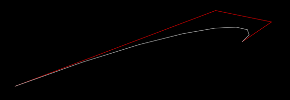

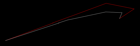

The calculation of the length along a polyline is very straightforward. For arc sections the distance along the arc is simply the radius of the arc times the angle subtended by the arc (in radians). Straight line sections, of course, are simply: Distance from point 1 to point 2 = square root ((x2-x1)^2 + (y2-y1)^2 +(z2-z1)^2) Things become a little more tricky with splines. The general spline in AutoCAD is known as a NURBS or non-uniform rational B-spline. NURBS, and its simpler special case forms named B-splines and Bezier splines are parametric functions. For parametric equations an independent variable,, the parameter (u), is used to specify a point on the curve. Give the equation for a spline a value for the parameter u and you'll get back the X,Y,Z coordinates of a point on the spline. This calculation is done quickly and efficiently. However, the calculation of distance along a spline is more complex. It requires mathematics known as numerical integration. Numerical calculations use a trial-and-error like approach to solving a problem. Repeated calculations are made and evaluated to determine the distance along the spline. In making these calculations the parameter u is repeatedly adjusted until the distance along the curve is within some acceptable tolerance. Bottom line? Locating a point on a spline with a parameter is much more efficient than locating a point on a spline given a distance. For example, the calculation for determining the intersection of two splines would manipulate values of u for the two splines on a trial and error basis until a value for each u yielded the same point in space within an acceptable tolerance. In this example, the distance along the curve is not needed. Yes, you can think of the "param" in getPointAtParamas for each segment as a percentage but be careful that for spline the parameter value cannot be directly converted to a distance along the spline since the parameter typically would not vary equally with distance. A nice attribute of parametric splines is that for evenly distributed values of the parameter you will get more points in areas of sharp curvature and in areas of flatter curvature. A simple demonstration of this feature can be shown with a polyline-spline and the splineegs command. In the image below the red line was copied and then using pedit-spline turned iinto a spline. The default value for splinesegs his 8. To draw the spline AutoCAD uses values of 0.0, 0.125, 0.25, 0.375, …, 1.0 for u to determine the chords to draw to represent the spline. Looking closely at the white curve you will see that it's composed of eight straight sections note how they are shorter where the curvature is smaller. If splinesegs is changed to 4, and the spline is decurved and then then splined again the result is as follows. Four chords are used to represent the spline and it looks very crude. If splinesegs is changed to 4, and the spline is decurved and then then splined again the result is as follows. Four chords are used to represent the spline and it looks very crude. On a completely separate but related note, last year I posted this 3ds Max Tutorial on using numerical methods to animate the boom of a trolley conected to an overhead cable. Even if you are not a 3ds Max user or familiar with Max scripts I think you can see how the function interpcurve3d at 6:23 in the video is used to find a point on a curve using a parameter can be helpful in solving such a problem.1 point
You might find my ssget Function Reference of interest - it contains slightly more information than the standard documentation.1 point
Curves have an independent parameter, let's call it u. For a polyline consisting of one arc the range for u is 0 to 1. If the polyline has two arcs the range for u would be 0 to 2. If u were between 0 and 1 then the point is on the first arc segment. If u is between 1 and 2 then the point is on the second arc segment. Note that the distance along the arc from say, u = 1.1 to 1.2 would be the same as from 1.2 to 1.3 but not equal to the distance from 2.1 to 2.2 since the second arc may have a different radius and subtended angle. vlax-curve-getPointAtParam is used to work with the paramter (u) while vlax-curve-getPointAtDist is used to work with the distace measured along th curve. Note, for Bezier and B-Splines (AutoCAD splines) the maximum parameter variable is an integer. For NURBS the maximum value could be a real number (that's why they are called "non-uniform").1 point

@zwonko The function vlax-curve-getPointAtParam does not increase linearly with respect to distance if the curve does not have a constant radius. SInce your polyline has more than one arc segment and they are of different radii you should not be computng the interval in parametric space. Use vlax-curve-getPointAtDist instead.1 point
