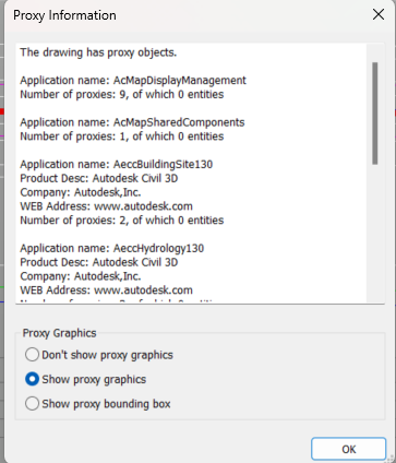

  5. Every surface is saved in the drawing itself. Which is why I see drawings that are anywhere from 5 to 150 MB in size. Welcome to the forum!
