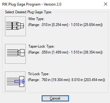

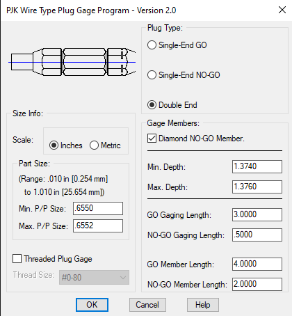

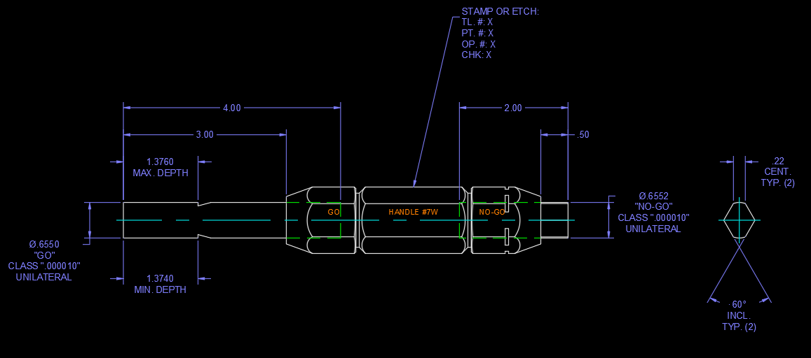

  1. Another Example: I wrote this back in the 90's (believe it or not) and still maintain it for drawing ANSI plug gages. It fully draws everything with Visual LISP. I Don't even use it anymore, but it's a good resource that I use as a test bed for trying out better code, and keeping myself exercised in LISP programming.
