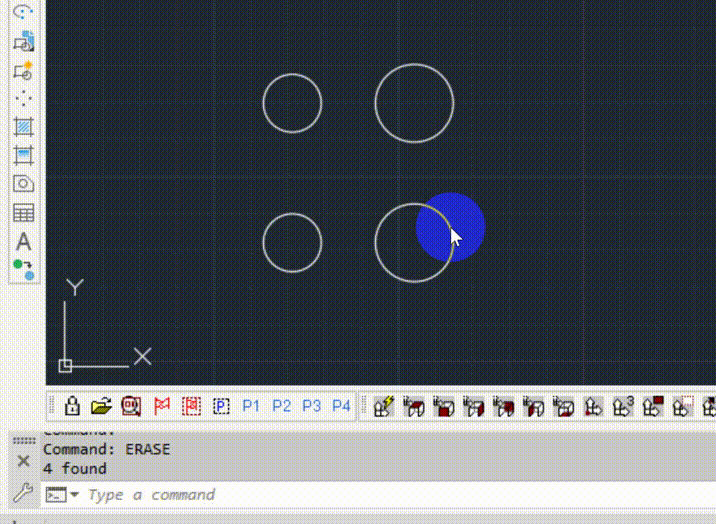

  8. [XDrX-PlugIn(159)] Create snake line over a circle (theswamp.org) https://www.theswamp.org/index.php?topic=59526.0 (defun c:xdtb_snakecircle (/ an box cir direc dist e1 e2 endln ents ents-pair ept1 ept2 firstln garc i ints items ln1 ln2 mode p1extend pl ptmid pts1 pts2 spt1 spt2 x y ) (defun _make-sharp-corners (direc) (setq items (nth direc ents-pair) e1 (car items) e2 (cadr items) ept2 (xdrx-curve-getendpoint e2) spt2 (xdrx-curve-getstartpoint e2) spt1 (xdrx-curve-getstartpoint e1) ept1 (xdrx-curve-getendpoint e1) ) (cond ((= (rem direc 2) 0) (if (< direc (/ #xd-var-global-divide-nums 2.0)) (progn (setq p1extend (xdrx-getpropertyvalue (list spt1 ept1) "getclosestpointto" ept2 t ) ptmid (xdrx-line-midp ept2 p1extend) ) (xdrx-curve-setsptept e1 ept1 p1extend) (if (= #xd-var-global-mode "1") (progn (setq ptmid (polar ptmid 0 (distance ptmid ept2))) (setq garc (xdge::constructor "kCircArc3d" p1extend ptmid ept2 ) ) (xdrx-entity-make garc) ) (progn (setq ptmid (polar ptmid 0 (* (distance ptmid ept2) 1.3))) (xdrx-line-make p1extend ptmid) (xdrx-line-make ptmid ept2) ) ) ) (progn (setq p1extend (xdrx-getpropertyvalue (list spt2 ept2) "getclosestpointto" ept1 t ) ptmid (xdrx-line-midp ept1 p1extend) ) (xdrx-curve-setsptept e2 ept2 p1extend) (if (= #xd-var-global-mode "1") (progn (setq ptmid (polar ptmid 0 (distance ptmid ept1))) (setq garc (xdge::constructor "kCircArc3d" p1extend ptmid ept1 ) ) (xdrx-entity-make garc) ) (progn (setq ptmid (polar ptmid 0 (* (distance ptmid ept1) 1.3))) (xdrx-line-make ept1 ptmid) (xdrx-line-make ptmid p1extend) ) ) ) ) ) (t (if (< direc (/ #xd-var-global-divide-nums 2.0)) (progn (setq p1extend (xdrx-getpropertyvalue (list spt1 ept1) "getclosestpointto" spt2 t ) ptmid (xdrx-line-midp spt2 p1extend) ) (xdrx-curve-setsptept e1 spt1 p1extend) (if (= #xd-var-global-mode "1") (progn (setq ptmid (polar ptmid pi (distance ptmid spt2))) (setq garc (xdge::constructor "kCircArc3d" p1extend ptmid spt2 ) ) (xdrx-entity-make garc) ) (progn (setq ptmid (polar ptmid pi (* (distance ptmid spt2) 1.3))) (xdrx-line-make p1extend ptmid) (xdrx-line-make ptmid spt2) ) ) ) (progn (setq p1extend (xdrx-getpropertyvalue (list spt2 ept2) "getclosestpointto" spt1 t ) ptmid (xdrx-line-midp spt1 p1extend) ) (xdrx-curve-setsptept e2 spt2 p1extend) (if (= #xd-var-global-mode "1") (progn (setq ptmid (polar ptmid pi (distance ptmid spt1))) (setq garc (xdge::constructor "kCircArc3d" p1extend ptmid spt1 ) ) (xdrx-entity-make garc) ) (progn (setq ptmid (polar ptmid pi (* (distance ptmid spt1) 1.3))) (xdrx-line-make spt1 ptmid) (xdrx-line-make ptmid p1extend) ) ) ) ) ) ) ) (setq #xd-var-global-mode "0") (xdrx-initget 0 "0 1") (if (setq mode (getkword (xdrx-string-formatex (xdrx-string-multilanguage "\n模式[标准(0)/圆弧(1)]<1>" "\nMode[standard(0)/arc(1)]<%s>") #xd-var-global-mode ) ) ) (setq #xd-var-global-mode mode) ) (xdrx-initget) (xd::doc:getint (xdrx-string-multilanguage "\n等分数" "\nDivide Nums") "#xd-var-global-divide-nums" 20 ) (if (setq cir (car (xdrx-entsel (xdrx-string-multilanguage "\n拾取圆<退出>:" "\nPick Circle<Exit>:") '((0 . "circle")) ) ) ) (progn (xdrx-begin) (xdrx-setmark) (setq box (xdrx-entity-box cir) ln1 (list (nth 3 box) (nth 0 box)) pts1 (xdrx-getpropertyvalue ln1 "getsamplepoints" #xd-var-global-divide-nums ) ln2 (list (nth 2 box) (nth 1 box)) pts2 (xdrx-getpropertyvalue ln2 "getsamplepoints" #xd-var-global-divide-nums ) an (angle (car pts2) (car pts1)) firstln (list (polar (car pts1) an (/ (distance (car pts1) (car pts2) ) 7.0 ) ) (car pts2) ) an (angle (car pts1) (car pts2)) dist (/ (distance (last pts1) (last pts2)) 7.0) endln (if (= (rem #xd-var-global-divide-nums 2) 1) (list (polar (last pts1) (+ an pi) dist) (last pts2)) (list (last pts1) (polar (last pts2) an dist)) ) pts1 (cdr (xd::list:removetail pts1)) pts2 (cdr (xd::list:removetail pts2)) ents nil ) (xdrx-line-make firstln) (setq ents (cons (entlast) ents)) (mapcar '(lambda (x y) (setq ints (xdrx-entity-intersectwith (list x y) cir) ints (xdrx-points-sortoncurve (list x y) ints) ) (apply 'xdrx-line-make ints ) (setq ents (cons (entlast) ents)) ) pts1 pts2 ) (xdrx-line-make endln) (setq ents (cons (entlast) ents) ents (reverse ents) ents-pair (xd::list:snakepair ents) ) (setq i -1) (repeat (length ents-pair) (setq i (1+ i)) (_make-sharp-corners i) ) (xdrx-curve-join (xdrx-getss)) (setq pl (entlast)) (xdrx-entity-setcolor pl 1) (xdrx-end) ) ) (princ) ) ===================== The above code uses XDrx API, download link: https://github.com/xdcad/XDrx-API-zip https://sourceforge.net/projects/xdrx-api-zip/ Dual version link: https://github.com/xdcad

  10. Here is version for ellipse... (defun c:snakeoverellipse ( / *error* *adoc* el orth ell ce r1 r2 n c d p k p1 p2 pl bl ) (vl-load-com) (defun *error* ( m ) (if orth (setvar 'orthomode orth) ) (vla-endundomark *adoc*) (if m (prompt m) ) (princ) ) (vla-startundomark (setq *adoc* (vla-get-activedocument (vlax-get-acad-object)))) (setq el (entlast)) (setq orth (getvar 'orthomode)) (setvar 'orthomode 1) (prompt "\nPick or specify point to create snake over ellipse - when draw mode of ELLIPSE firstly create X axis radius and then Y axis radius : ") (command "_.ELLIPSE" "_C") (while (< 0 (getvar 'cmdactive)) (command "\\") ) (if (not (eq el (entlast))) (progn (setq ell (entlast)) (setq ce (trans (cdr (assoc 10 (entget ell))) 0 1)) (setq r1 (abs (apply '+ (trans (cdr (assoc 11 (entget ell))) 0 (cdr (assoc 210 (entget ell))))))) (setq r2 (* r1 (cdr (assoc 40 (entget ell))))) (initget 7) (setq n (getint "\nSpecify number of double turns : ")) (initget 1 "Yes No") (setq c (getkword "\nAdditional middle turn [Yes/No] : ")) (if (= c "Yes") (progn (if (equal (cadr (trans (cdr (assoc 11 (entget ell))) 0 (cdr (assoc 210 (entget ell))))) 0.0 1e-8) (progn (setq d (/ (* 2 r2) (1+ (* 2 n)))) (setq p (list (+ (car ce) r1) (- (cadr ce) r2))) (setq pl (cons p pl)) (setq k -1) (repeat n (setq k (1+ k)) (setq p1 (polar (list (car ce) (+ (- (cadr ce) r2) (* (1+ k) d))) (* (1+ k) pi) (sqrt (- (expt r2 2) (expt (- r2 (* (1+ k) d)) 2))))) (setq p1 (polar (list (car ce) (+ (- (cadr ce) r2) (* k d))) (* (1+ k) pi) (abs (- (car (polar ce (angle ce p1) r1)) (car ce))))) (setq p2 (polar p1 (* 0.5 pi) d)) (setq pl (cons p1 pl) pl (cons p2 pl)) ) (setq p (polar (list (car ce) (cadr p2)) (if (= (rem n 2) 0) pi 0.0) (sqrt (- (expt r2 2) (expt (/ d 2) 2))))) (setq p (polar (list (car ce) (cadr p2)) (if (= (rem n 2) 0) pi 0.0) (abs (- (car (polar ce (angle ce p) r1)) (car ce))))) (setq pl (cons p pl)) (setq p (polar p (* 0.5 pi) d)) (setq pl (cons p pl)) (setq k -1) (repeat n (setq k (1+ k)) (setq p1 (polar (list (car ce) (+ (cadr ce) (* k d) (/ d 2))) (* (+ n k) pi) (sqrt (- (expt r2 2) (expt (* (+ k 0.5) d) 2))))) (setq p1 (polar (list (car ce) (+ (cadr ce) (* k d) (/ d 2))) (* (+ n k) pi) (abs (- (car (polar ce (angle ce p1) r1)) (car ce))))) (setq p2 (polar p1 (* 0.5 pi) d)) (setq pl (cons p1 pl) pl (cons p2 pl)) ) (setq p (list (+ (car ce) r1) (+ (cadr ce) r2))) (setq pl (cons p pl)) (setq pl (reverse pl)) ) (progn (setq d (/ (* 2 r1) (1+ (* 2 n)))) (setq p (list (+ (car ce) r2) (- (cadr ce) r1))) (setq pl (cons p pl)) (setq k -1) (repeat n (setq k (1+ k)) (setq p1 (polar (list (car ce) (+ (- (cadr ce) r1) (* (1+ k) d))) (* (1+ k) pi) (sqrt (- (expt r1 2) (expt (- r1 (* (1+ k) d)) 2))))) (setq p1 (polar (list (car ce) (+ (- (cadr ce) r1) (* k d))) (* (1+ k) pi) (abs (- (car (polar ce (angle ce p1) r2)) (car ce))))) (setq p2 (polar p1 (* 0.5 pi) d)) (setq pl (cons p1 pl) pl (cons p2 pl)) ) (setq p (polar (list (car ce) (cadr p2)) (if (= (rem n 2) 0) pi 0.0) (sqrt (- (expt r1 2) (expt (/ d 2) 2))))) (setq p (polar (list (car ce) (cadr p2)) (if (= (rem n 2) 0) pi 0.0) (abs (- (car (polar ce (angle ce p) r2)) (car ce))))) (setq pl (cons p pl)) (setq p (polar p (* 0.5 pi) d)) (setq pl (cons p pl)) (setq k -1) (repeat n (setq k (1+ k)) (setq p1 (polar (list (car ce) (+ (cadr ce) (* k d) (/ d 2))) (* (+ n k) pi) (sqrt (- (expt r1 2) (expt (* (+ k 0.5) d) 2))))) (setq p1 (polar (list (car ce) (+ (cadr ce) (* k d) (/ d 2))) (* (+ n k) pi) (abs (- (car (polar ce (angle ce p1) r2)) (car ce))))) (setq p2 (polar p1 (* 0.5 pi) d)) (setq pl (cons p1 pl) pl (cons p2 pl)) ) (setq p (list (+ (car ce) r2) (+ (cadr ce) r1))) (setq pl (cons p pl)) (setq pl (reverse pl)) ) ) (setq bl (cons 0.0 bl)) (setq k -1) (repeat (- (length pl) 2) (setq k (1+ k)) (if (= (rem k 2) 0) (setq bl (cons 0.0 bl)) (setq bl (if (zerop (apply '+ bl)) (cons -1.0 bl) (cons 1.0 bl))) ) ) (setq bl (cons 0.0 bl)) ) (progn (if (equal (cadr (trans (cdr (assoc 11 (entget ell))) 0 (cdr (assoc 210 (entget ell))))) 0.0 1e-8) (progn (setq d (/ r2 n)) (setq p (list (+ (car ce) r1) (- (cadr ce) r2))) (setq pl (cons p pl)) (setq k -1) (repeat n (setq k (1+ k)) (setq p1 (polar (list (car ce) (+ (- (cadr ce) r2) (* (1+ k) d))) (* (1+ k) pi) (sqrt (- (expt r2 2) (expt (- r2 (* (1+ k) d)) 2))))) (setq p1 (polar (list (car ce) (+ (- (cadr ce) r2) (* k d))) (* (1+ k) pi) (abs (- (car (polar ce (angle ce p1) r1)) (car ce))))) (setq p2 (polar p1 (* 0.5 pi) d)) (setq pl (cons p1 pl) pl (cons p2 pl)) ) (setq k -1) (repeat n (setq k (1+ k)) (setq p1 (polar (list (car ce) (+ (cadr ce) (* k d))) (* (+ n (1+ k)) pi) (sqrt (- (expt r2 2) (expt (* k d) 2))))) (setq p1 (polar (list (car ce) (+ (cadr ce) (* k d))) (* (+ n (1+ k)) pi) (abs (- (car (polar ce (angle ce p1) r1)) (car ce))))) (setq p2 (polar p1 (* 0.5 pi) d)) (setq pl (cons p1 pl) pl (cons p2 pl)) ) (setq p (list (- (car ce) r1) (+ (cadr ce) r2))) (setq pl (cons p pl)) (setq pl (reverse pl)) ) (progn (setq d (/ r1 n)) (setq p (list (+ (car ce) r2) (- (cadr ce) r1))) (setq pl (cons p pl)) (setq k -1) (repeat n (setq k (1+ k)) (setq p1 (polar (list (car ce) (+ (- (cadr ce) r1) (* (1+ k) d))) (* (1+ k) pi) (sqrt (- (expt r1 2) (expt (- r1 (* (1+ k) d)) 2))))) (setq p1 (polar (list (car ce) (+ (- (cadr ce) r1) (* k d))) (* (1+ k) pi) (abs (- (car (polar ce (angle ce p1) r2)) (car ce))))) (setq p2 (polar p1 (* 0.5 pi) d)) (setq pl (cons p1 pl) pl (cons p2 pl)) ) (setq k -1) (repeat n (setq k (1+ k)) (setq p1 (polar (list (car ce) (+ (cadr ce) (* k d))) (* (+ n (1+ k)) pi) (sqrt (- (expt r1 2) (expt (* k d) 2))))) (setq p1 (polar (list (car ce) (+ (cadr ce) (* k d))) (* (+ n (1+ k)) pi) (abs (- (car (polar ce (angle ce p1) r2)) (car ce))))) (setq p2 (polar p1 (* 0.5 pi) d)) (setq pl (cons p1 pl) pl (cons p2 pl)) ) (setq p (list (- (car ce) r2) (+ (cadr ce) r1))) (setq pl (cons p pl)) (setq pl (reverse pl)) ) ) (setq bl (cons 0.0 bl)) (setq k -1) (repeat (- (length pl) 2) (setq k (1+ k)) (if (= (rem k 2) 0) (setq bl (cons 0.0 bl)) (setq bl (if (zerop (apply '+ bl)) (cons 1.0 bl) (cons -1.0 bl))) ) ) (setq bl (cons 0.0 bl)) ) ) (entmake (append (list '(0 . "LWPOLYLINE") '(100 . "AcDbEntity") '(100 . "AcDbPolyline") (cons 90 (length pl)) (cons 70 (if (= (getvar 'plinegen) 1) 128 0)) (cons 38 (caddr (trans (cdr (assoc 10 (entget ell))) 0 (cdr (assoc 210 (entget ell)))))) ) (apply 'append (mapcar '(lambda ( a b ) (list (cons 10 (trans a 1 (cdr (assoc 210 (entget ell))))) (cons 42 b))) pl bl)) (list (assoc 210 (entget ell))) (list '(62 . 3)) ) ) ) ) (*error* nil) ) HTH, M.R.
    1 point
  11. Here is my version with bulges - arcs... (defun c:snakeovercircle ( / *error* *adoc* el ci ce r n c d p k p1 p2 pl bl ) (vl-load-com) (defun *error* ( m ) (vla-endundomark *adoc*) (if m (prompt m) ) (princ) ) (vla-startundomark (setq *adoc* (vla-get-activedocument (vlax-get-acad-object)))) (setq el (entlast)) (prompt "\nPick or specify point to create snake over circle : ") (command "_.CIRCLE") (while (< 0 (getvar 'cmdactive)) (command "\\") ) (if (not (eq el (entlast))) (progn (setq ci (entlast)) (setq ce (cdr (assoc 10 (entget ci)))) (setq r (cdr (assoc 40 (entget ci)))) (initget 7) (setq n (getint "\nSpecify number of double turns : ")) (initget 1 "Yes No") (setq c (getkword "\nAdditional middle turn [Yes/No] : ")) (if (= c "Yes") (progn (setq d (/ (* 2 r) (1+ (* 2 n)))) (setq p (list (+ (car ce) r) (- (cadr ce) r))) (setq pl (cons p pl)) (setq k -1) (repeat n (setq k (1+ k)) (setq p1 (polar (list (car ce) (+ (- (cadr ce) r) (* k d))) (* (1+ k) pi) (sqrt (- (expt r 2) (expt (- r (* (1+ k) d)) 2))))) (setq p2 (polar p1 (* 0.5 pi) d)) (setq pl (cons p1 pl) pl (cons p2 pl)) ) (setq p (polar (list (car ce) (cadr p2)) (if (= (rem n 2) 0) pi 0.0) (sqrt (- (expt r 2) (expt (/ d 2) 2))))) (setq pl (cons p pl)) (setq p (polar p (* 0.5 pi) d)) (setq pl (cons p pl)) (setq k -1) (repeat n (setq k (1+ k)) (setq p1 (polar (list (car ce) (+ (cadr ce) (* k d) (/ d 2))) (* (+ n k) pi) (sqrt (- (expt r 2) (expt (* (+ k 0.5) d) 2))))) (setq p2 (polar p1 (* 0.5 pi) d)) (setq pl (cons p1 pl) pl (cons p2 pl)) ) (setq p (list (+ (car ce) r) (+ (cadr ce) r))) (setq pl (cons p pl)) (setq pl (reverse pl)) (setq bl (cons 0.0 bl)) (setq k -1) (repeat (- (length pl) 2) (setq k (1+ k)) (if (= (rem k 2) 0) (setq bl (cons 0.0 bl)) (setq bl (if (zerop (apply '+ bl)) (cons -1.0 bl) (cons 1.0 bl))) ) ) (setq bl (cons 0.0 bl)) ) (progn (setq d (/ r n)) (setq p (list (+ (car ce) r) (- (cadr ce) r))) (setq pl (cons p pl)) (setq k -1) (repeat n (setq k (1+ k)) (setq p1 (polar (list (car ce) (+ (- (cadr ce) r) (* k d))) (* (1+ k) pi) (sqrt (- (expt r 2) (expt (- r (* (1+ k) d)) 2))))) (setq p2 (polar p1 (* 0.5 pi) d)) (setq pl (cons p1 pl) pl (cons p2 pl)) ) (setq k -1) (repeat n (setq k (1+ k)) (setq p1 (polar (list (car ce) (+ (cadr ce) (* k d))) (* (+ n (1+ k)) pi) (sqrt (- (expt r 2) (expt (* k d) 2))))) (setq p2 (polar p1 (* 0.5 pi) d)) (setq pl (cons p1 pl) pl (cons p2 pl)) ) (setq p (list (- (car ce) r) (+ (cadr ce) r))) (setq pl (cons p pl)) (setq pl (reverse pl)) (setq bl (cons 0.0 bl)) (setq k -1) (repeat (- (length pl) 2) (setq k (1+ k)) (if (= (rem k 2) 0) (setq bl (cons 0.0 bl)) (setq bl (if (zerop (apply '+ bl)) (cons 1.0 bl) (cons -1.0 bl))) ) ) (setq bl (cons 0.0 bl)) ) ) (entmake (append (list '(0 . "LWPOLYLINE") '(100 . "AcDbEntity") '(100 . "AcDbPolyline") (cons 90 (length pl)) (cons 70 (if (= (getvar 'plinegen) 1) 128 0)) (cons 38 (caddr (cdr (assoc 10 (entget ci))))) ) (apply 'append (mapcar '(lambda ( a b ) (list (cons 10 a) (cons 42 b))) pl bl)) (list (assoc 210 (entget ci))) (list '(62 . 3)) ) ) ) ) (*error* nil) ) HTH, M.R.
