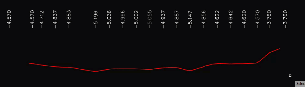

  3. @Noor-Cad Give this a try. It will maintain the differing Z vales of your text. (defun c:foo (/ ln o p pl s txt) ;; RJP » 2024-06-24 (cond ((setq s (ssget ":L" '((0 . "*TEXT,LWPOLYLINE")))) (foreach e (vl-remove-if 'listp (mapcar 'cadr (ssnamex s))) (if (= "AcDbPolyline" (vla-get-objectname (setq o (vlax-ename->vla-object e)))) (setq pl o) (setq txt (cons (list o (vlax-get o 'textalignmentpoint)) txt)) ) ) (if pl (foreach tx txt (setq ln (entmakex (list '(0 . "LINE") (cons 10 (cadr tx)) (cons 11 (mapcar '+ (cadr tx) '(0 1 0))) '(8 . "TEMPLINE") ) ) ) (vla-put-elevation pl (last (cadr tx))) (if (setq p (vlax-invoke (vlax-ename->vla-object ln) 'intersectwith pl 3)) (progn (vlax-put (car tx) 'textalignmentpoint p) (entdel ln)) ) ) ) ) ) (princ) )
