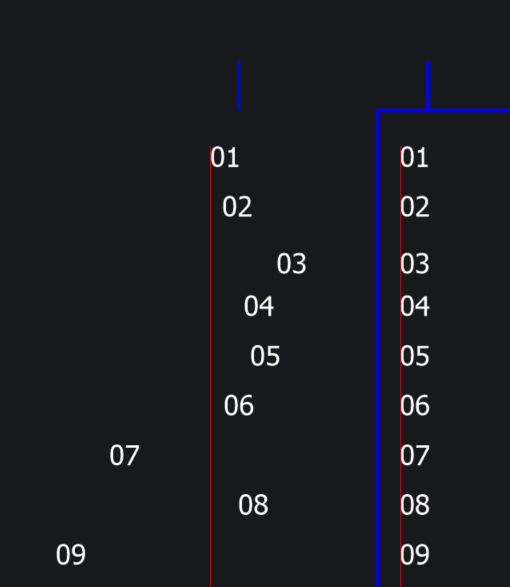

  6. I will double check what is posted is Ok. Found a command TJUST that should work in Acad and Bricscad. If not working Acad use _.justifytext. (command "TJUST" ss "" "MC") Found a problem in the while fixed that. Hopefully correct now. Did a little bit of reorganising code also. Just did 3 columns of text worked ok. ; https://www.cadtutor.net/forum/topic/88262-mtext-align-and-mtext-width-0/ ; simple align text to line : By AlanH July 2024 ;;; Justification Macros ;;; ;;; https://www.cadtutor.net/forum/topic/35569-text-justification-lisp/?do=findComment&comment=289008 ;;; ;;; BY alanjt (a.k.a. Alan J. Thompson) ;;; ;;; Customized By SLW210 ;;; (defun c:alt1 ( / _justifyIt ent fo x Y k ans but ss oldsnap pt obj ptn) (defun _justifyIt (justify title / ) (princ (strcat "\nSelect *Text to " title " justify: ")) (if (setq ss (ssget '((0 . "ATTDEF,MTEXT,TEXT")))) (command "_.TJUST" ss "" justify) ) (princ) ) (while (setq ent (car (entsel "\nPick single text for alignment Enter to exit "))) (if (= fname nil) (progn (setq fo (open (setq fname (vl-filename-mktemp "" "" ".dcl")) "w")) (write-line "AHtxtpos : dialog {" fo) (write-line " label =\"Please Choose \" ;" fo) (write-line " : column {" fo) (write-line " : boxed_radio_row {" fo) (write-line " width = 24 ;" fo) (write-line " : radio_button {" fo) (write-line "key = \"Rb1\";" fo) (write-line "label = \"Top L\";" fo) (write-line " }" fo) (write-line " : radio_button {" fo) (write-line "key = \"Rb2\";" fo) (write-line "label = \"Top Mid\";" fo) (write-line " }" fo) (write-line " : radio_button {" fo) (write-line "key = \"Rb3\";" fo) (write-line "label = \"Top R\";" fo) (write-line " }" fo) (write-line " }" fo) (write-line "spacer_1 ;" fo) (write-line " : boxed_radio_row {" fo) (write-line " : radio_button {" fo) (write-line "key = \"Rb4\";" fo) (write-line "label = \"Mid L\";" fo) (write-line " }" fo) (write-line " : radio_button {" fo) (write-line "key = \"Rb5\";" fo) (write-line "label = \"Center\";" fo) (write-line " }" fo) (write-line " : radio_button {" fo) (write-line "key = \"Rb6\";" fo) (write-line "label = \"Mid R\";" fo) (write-line " }" fo) (write-line " }" fo) (write-line "spacer_1 ;" fo) (write-line " : boxed_radio_row {" fo) (write-line " : radio_button {" fo) (write-line "key = \"Rb7\";" fo) (write-line "label = \"Bot L \";" fo) (write-line " }" fo) (write-line "spacer_1 ;" fo) (write-line " : radio_button {" fo) (write-line "key = \"Rb8\";" fo) (write-line "label = \"Bot mid\";" fo) (write-line " }" fo) (write-line " : radio_button {" fo) (write-line "key = \"Rb9\";" fo) (write-line "label = \"Bot R\";" fo) (write-line " }" fo) (write-line " }" fo) (write-line "spacer_1 ;" fo) (write-line " ok_cancel;" fo) (write-line " }" fo) (write-line " }" fo) (close fo) ) ) (setq dcl_id (load_dialog fname)) (if (not (new_dialog "AHtxtpos" dcl_id) ) (exit) ) (set_tile "Rb1" "1") (setq x 1) (repeat 9 (setq k (strcat "Rb" (rtos x 2 0))) (action_tile k (strcat "(setq but " (rtos x 2 0) ")" "(done_dialog)")) (setq x (+ x 1)) ) (action_tile "accept" "(done_dialog)") (start_dialog) (unload_dialog dcl_id) (cond ((= but 1)(_justifyIt "_TL" "Top Left")) ((= but 2)(_justifyIt "_TC" "Top Center")) ((= but 3)(_justifyIt "_TR" "Top Right")) ((= but 4)(_justifyIt "_ML" "Middle Left")) ((= but 5)(_justifyIt "_MC" "Middle Center")) ((= but 6)(_justifyIt "_MR" "Middle Right")) ((= but 7)(_justifyIt "_BL" "Bottom Left")) ((= but 8)(_justifyIt "_BC" "Bottom Center")) ((= but 9)(_justifyIt "_BR" "Bottom Right")) ) (if (not AH:Butts)(load "Multi Radio buttons.lsp")) (if (= ahdef nil)(setq ahdef 1)) (setq oldsnap (getvar 'osmode)) (setvar 'osmode 0) (setq ans (ah:butts ahdef "h" '("Horizontal or vertical " "Hor " "Ver"))) ; ans holds the button picked value (setq ahdef but) (setq pt (cdr (assoc 10 (entget ent)))) (setq X (car pt) Y (cadr pt)) (if (= ss nil) (progn (alert "You have not selected anything will now exit")(exit)) ) (repeat (setq k (sslength ss)) (setq obj (vlax-ename->vla-object (ssname ss (setq k (- k 1))))) (setq ptn (vlax-get obj 'Insertionpoint)) (if (= ahdef 1) (setq ptn (list (car ptn) Y 0.0)) (setq ptn (list X (cadr ptn) 0.0)) ) (vlax-put obj 'insertionpoint ptn) ) ; repeat ) ; while (vl-file-delete fname) (setvar 'osmode oldsnap) (princ) ) (C:alt1) Re Error message got similar at another post, forums/autodesk, I think it may be I am using Bricscad and it may accept X,Y as a point but Acad wants X,Y,Z. I have added the z=0 to pnt please let me know if that fixes it.

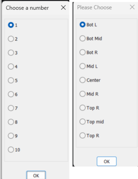

  7. Maybe just wblock out some bits and insert into a single sample dwg. You can use the dcl above then only need 1 defun command for justification pick. Maybe write the dcl and save, then no need to continually write it just change the mk-temp to a file name. May speed up things. Had another go pick a single text as the reference, then select all text, input Vertical or Horizontal. One issue was where I picked a point and moved others but they had different justifications. (defun c:alt1 ( / ss x Y k ans) (if (not AH:Butts)(load "Multi Radio buttons.lsp")) (if (= ahdef nil)(setq ahdef 1)) (setq oldsnap (getvar 'osmode)) (setvar 'osmode 0) (while (setq ent (car (entsel "\nPick text for alignment reference point Enter to exit "))) (setq ans (ah:butts ahdef "h" '("Horizontal or vertical " "Hor " "Ver"))) ; ans holds the button picked value (setq ahdef but) (setq pt (cdr (assoc 10 (entget ent)))) (setq X (car pt) Y (cadr pt)) (prompt "\nSelect text ") (setq ss (ssget '((0 . "*TEXT")))) (if (= ss nil) (progn (alert "You have not selected anything will now exit")(exit)) ) (repeat (setq k (sslength ss)) (setq obj (vlax-ename->vla-object (ssname ss (setq k (- k 1))))) (setq ptn (vlax-get obj 'Insertionpoint)) (if (= ahdef 1) (setq Ptn (list (car ptn) Y )) (setq Ptn (list X (cadr ptn))) )m (vlax-put obj 'insertionpoint ptn) ) ) (setvar 'osmode 0) (princ) ) (C:alt1) Multi radio buttons.lsp The multi radio should remember last Hor or ver, so can do enter if it doesn't let me know was a bug in a version I posted here. Still thinking about auto Ver or Hor.

  8. Had another go this may be useful for justification. (defun wow ( / fo dcl_id fname x) (setq fo (open (setq fname (vl-filename-mktemp "" "" ".dcl")) "w")) (write-line "AHtxtpos : dialog {" fo) (write-line " label =\"Please Choose \" ;" fo) (write-line " : column {" fo) (write-line " : boxed_radio_row {" fo) (write-line " width = 24 ;" fo) (write-line " : radio_button {" fo) (write-line "key = \"Rb1\";" fo) (write-line "label = \"Top L\";" fo) (write-line " }" fo) (write-line " : radio_button {" fo) (write-line "key = \"Rb2\";" fo) (write-line "label = \"Top Mid\";" fo) (write-line " }" fo) (write-line " : radio_button {" fo) (write-line "key = \"Rb3\";" fo) (write-line "label = \"Top R\";" fo) (write-line " }" fo) (write-line " }" fo) (write-line "spacer_1 ;" fo) (write-line " : boxed_radio_row {" fo) (write-line " : radio_button {" fo) (write-line "key = \"Rb4\";" fo) (write-line "label = \"Mid L\";" fo) (write-line " }" fo) (write-line " : radio_button {" fo) (write-line "key = \"Rb5\";" fo) (write-line "label = \"Center\";" fo) (write-line " }" fo) (write-line " : radio_button {" fo) (write-line "key = \"Rb6\";" fo) (write-line "label = \"Mid R\";" fo) (write-line " }" fo) (write-line " }" fo) (write-line "spacer_1 ;" fo) (write-line " : boxed_radio_row {" fo) (write-line " : radio_button {" fo) (write-line "key = \"Rb7\";" fo) (write-line "label = \"Bot L \";" fo) (write-line " }" fo) (write-line "spacer_1 ;" fo) (write-line " : radio_button {" fo) (write-line "key = \"Rb8\";" fo) (write-line "label = \"Bot mid\";" fo) (write-line " }" fo) (write-line " : radio_button {" fo) (write-line "key = \"Rb9\";" fo) (write-line "label = \"Bot R\";" fo) (write-line " }" fo) (write-line " }" fo) (write-line "spacer_1 ;" fo) (write-line " ok_cancel;" fo) (write-line " }" fo) (write-line " }" fo) (close fo) (setq dcl_id (load_dialog fname)) (if (not (new_dialog "AHtxtpos" dcl_id) ) (exit) ) (set_tile "Rb1" "1") (setq x 1) (repeat 9 (setq k (strcat "Rb" (rtos x 2 0))) (action_tile k (strcat "(setq but " (rtos x 2 0) ")" "(done_dialog)")) (setq x (+ x 1)) ) (action_tile "accept" "(done_dialog)") (start_dialog) (unload_dialog dcl_id) (vl-file-delete fname) (cond ((= but 1)(setq pos "TL")) ((= but 2)(setq pos "TM")) ((= but 3)(setq pos "TR")) ((= but 4)(setq pos "LM")) ((= but 5)(setq pos "Cen")) ((= but 6)(setq pos "RM")) ((= but 7)(setq pos "BL")) ((= but 8)(setq pos "BM")) ((= but 9)(setq pos "BR")) ) (princ) ) (wow)

  9. Not sure which text but if its the 1-41 using get-closestpointo should do the trick. You could also select and sort on Y replace X with a fixed value. also replace Y with a fixed increment value. Using a start end point how many etc. I think found some #12/A/IR match yellow line. Tested on the 2 examples and 1-41. ; simple align text to line ; By AlanH July 2024 ; align text option 1 may need alt2 alt3 etc (defun c:alt1 ( / ss x ) (while (setq ent (car (entsel "\nSelect a line object "))) (setq obj (vlax-ename->vla-object ent)) (setq ss (ssget '((0 . "*TEXT")))) (if (= ss nil)(progn (alert "you have not picked any M or text objects \nwill now exit")(exit))) (repeat (setq x (sslength ss)) (setq obj2 (vlax-ename->vla-object (ssname ss (setq x (- x 1))))) (setq pt1 (vlax-get obj2 'insertionpoint )) (setq pt2 (vlax-curve-getclosestpointto obj pt1)) (vla-move obj2 pt1 pt2) ) ) (princ) ) Re alignment problems if you can provide raw text that needs fixing and the options to align. A quick answer is the 9 positions 1-9 for text as a number for me as per image either option probably do a 3x3 dcl. Thinking more if normally Hor or Ver could just select text and use correct X or Y for all text no need for line say use 1st text for that position.
