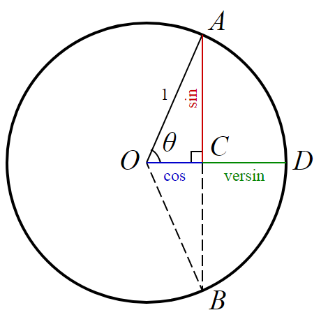

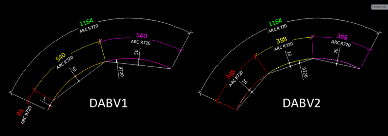

Do you mean chord length or versine? Chord is AB, versine is CD I was intrigued by this requested - and wanted to test ChatGPTs LISP and math prowess (not sure if allowed - and apologies if this is an insult to the resident LISP gurus!). Results might be useful, but I was impressed it was able to get this far. It took 9 attempts to arrive at this code 2 routines below: DABV1 - divides an ARC into lengths according to specified versine, with a 'remainder' arc DBAV2 - creates equal arc lengths up to maximum of specified versine (defun c:DABV1 ( / arcEntity arcData center radius startAngle endAngle versine chordLength angleIncrement totalAngle numSegments newArcs i angle1 angle2) ;; Function to calculate the arc sine (asin) value (defun asin (x) (atan (/ x (sqrt (- 1 (* x x)))))) ;; Function to calculate the chord length for a given versine and radius (defun chord-for-versine (v r) (* 2 (sqrt (- (* r r) (* (- r v) (- r v)))))) ;; Function to calculate the angle increment for a given chord length and radius (defun angle-for-chord-length (c r) (* 2 (asin (/ (/ c 2) r)))) ;; Get the arc entity from the user (setq arcEntity (entsel "\nSelect an arc: ")) (if (and arcEntity (setq arcEntity (car arcEntity))) (progn (setq arcData (entget arcEntity)) ;; Check if the selected entity is an arc (if (eq (cdr (assoc 0 arcData)) "ARC") (progn ;; Get the arc properties (setq center (cdr (assoc 10 arcData))) (setq radius (cdr (assoc 40 arcData))) (setq startAngle (cdr (assoc 50 arcData))) (setq endAngle (cdr (assoc 51 arcData))) ;; Prompt the user for the versine length (setq versine (getreal "\nEnter the versine length: ")) ;; Ensure versine and radius are positive and radius is non-zero (if (and versine (> versine 0) radius (> radius 0)) (progn ;; Calculate the chord length for the given versine length (setq chordLength (chord-for-versine versine radius)) ;; Calculate the angle increment for the given chord length (setq angleIncrement (angle-for-chord-length chordLength radius)) ;; Calculate the total angle of the arc (setq totalAngle (- endAngle startAngle)) ;; Calculate the number of segments based on the total angle and the angle increment (setq numSegments (fix (/ totalAngle angleIncrement))) ;; Create new arcs (setq newArcs nil) (setq angle1 startAngle) (repeat numSegments (setq angle2 (+ angle1 angleIncrement)) (setq newArcs (cons (entmakex (list (cons 0 "ARC") (cons 10 center) (cons 40 radius) (cons 50 angle1) (cons 51 angle2))) newArcs)) (setq angle1 angle2) ) ;; If there's a remaining segment, add it (if (< angle1 endAngle) (setq newArcs (cons (entmakex (list (cons 0 "ARC") (cons 10 center) (cons 40 radius) (cons 50 angle1) (cons 51 endAngle))) newArcs)) ) ;; Display the new arcs (foreach arc newArcs (entdraw arc)) ) (princ "\nInvalid versine length or radius.") ) ) (princ "\nSelected entity is not an arc.") ) ) (princ "\nNo arc selected.") ) (princ) ) (defun ceiling (x) (if (= x (fix x)) (fix x) (+ (fix x) 1))) (defun c:DABV2 ( / arcEntity arcData center radius startAngle endAngle versine chordLength maxAngleIncrement totalAngle numSegments actualAngleIncrement newArcs i angle1 angle2) ;; Function to calculate the arc sine (asin) value (defun asin (x) (atan (/ x (sqrt (- 1 (* x x)))))) ;; Function to calculate the chord length for a given versine and radius (defun chord-for-versine (v r) (* 2 (sqrt (- (* r r) (* (- r v) (- r v)))))) ;; Function to calculate the angle increment for a given chord length and radius (defun angle-for-chord-length (c r) (* 2 (asin (/ (/ c 2) r)))) ;; Get the arc entity from the user (setq arcEntity (entsel "\nSelect an arc: ")) (if (and arcEntity (setq arcEntity (car arcEntity))) (progn (setq arcData (entget arcEntity)) ;; Check if the selected entity is an arc (if (eq (cdr (assoc 0 arcData)) "ARC") (progn ;; Get the arc properties (setq center (cdr (assoc 10 arcData))) (setq radius (cdr (assoc 40 arcData))) (setq startAngle (cdr (assoc 50 arcData))) (setq endAngle (cdr (assoc 51 arcData))) ;; Prompt the user for the versine length (setq versine (getreal "\nEnter the versine length: ")) ;; Ensure versine and radius are positive and radius is non-zero (if (and versine (> versine 0) radius (> radius 0)) (progn ;; Calculate the chord length for the given versine length (setq chordLength (chord-for-versine versine radius)) ;; Calculate the maximum angle increment for the given chord length (setq maxAngleIncrement (angle-for-chord-length chordLength radius)) ;; Calculate the total angle of the arc (setq totalAngle (- endAngle startAngle)) ;; Calculate the number of segments required, rounding up to ensure the versine is not exceeded (setq numSegments (ceiling (/ totalAngle maxAngleIncrement))) ;; Calculate the actual angle increment to evenly divide the arc into `numSegments` (setq actualAngleIncrement (/ totalAngle numSegments)) ;; Create new arcs (setq newArcs nil) (setq angle1 startAngle) (repeat numSegments (setq angle2 (+ angle1 actualAngleIncrement)) (setq newArcs (cons (entmakex (list (cons 0 "ARC") (cons 10 center) (cons 40 radius) (cons 50 angle1) (cons 51 angle2))) newArcs)) (setq angle1 angle2) ) ;; Display the new arcs (foreach arc newArcs (entdraw arc)) ) (princ "\nInvalid versine length or radius.") ) ) (princ "\nSelected entity is not an arc.") ) ) (princ "\nNo arc selected.") ) (princ) )1 point
