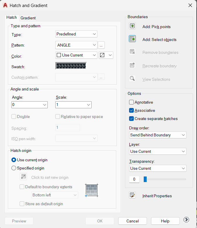

  1. (defun c:t1 ( / al ss ) (setq al (vla-get-activelayout (vla-get-ActiveDocument (vlax-get-acad-object)))) (if (setq ss (ssget "_X" (list '(0 . "LWPOLYLINE")))) (vlax-for o (setq s (vla-get-activeselectionset (vla-get-activedocument (vlax-get-acad-object)))) (setq h (vla-addhatch (vlax-get al 'block) acHatchPatternTypePredefined "SOLID" :vlax-true)) (vlax-invoke h 'AppendOuterLoop (list o))(vlax-invoke h 'Evaluate) ) ) (princ) ) (defun c:t2 ( / al ss) (setq al (vla-get-activelayout (vla-get-ActiveDocument (vlax-get-acad-object)))) (princ "\nSelect objects to apply solid hatch to : ") (if (setq ss (ssget (list '(0 . "LWPOLYLINE")))) (vlax-for o (setq s (vla-get-activeselectionset (vla-get-activedocument (vlax-get-acad-object)))) (setq h (vla-addhatch (vlax-get al 'block) acHatchPatternTypePredefined "SOLID" :vlax-true)) (vlax-invoke h 'AppendOuterLoop (list o))(vlax-invoke h 'Evaluate) ) ) (princ) )

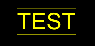

  11. Try this: (defun c:foo (/ o s) (if (setq s (ssget ":L" '((0 . "*TEXT")))) (foreach e (vl-remove-if 'listp (mapcar 'cadr (ssnamex s))) (setq o (vlax-ename->vla-object e)) (if (= "TEXT" (cdr (assoc 0 (entget e)))) (vla-put-textstring o (strcat "%%O" (vl-string-left-trim "%%O" (vla-get-textstring o)))) (vla-put-textstring o (strcat "\\O" (vl-string-left-trim "\\O" (vla-get-textstring o)))) ) ) ) (princ) )
