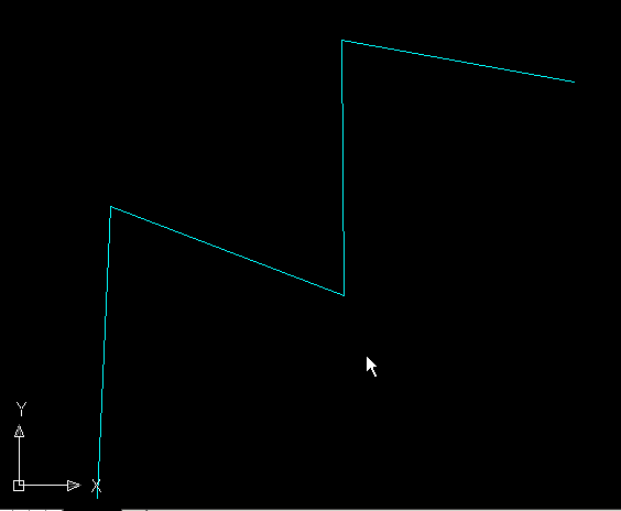

  10. You can either extract the coordinates with vla-get-coordinates and combine the list into groups of 3 or entnext through the selected ename (using entsel), create a list of coordinates (X,Y,Z), sort by Z value, then you can easily take the highest and lowest value and label accordingly. eg. HighLowLabel.zip
