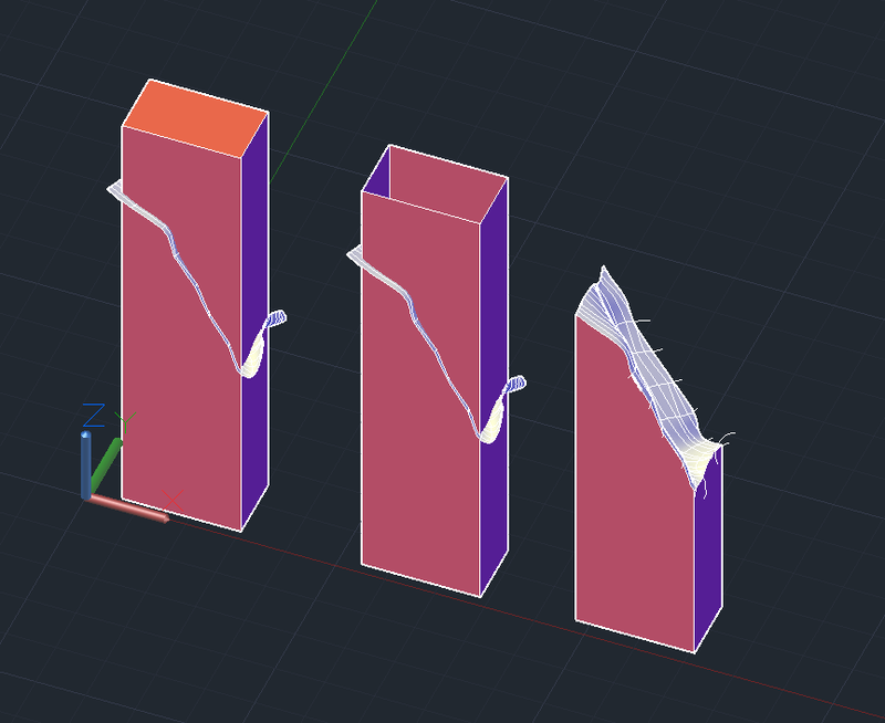

  3. After creating the surface with loft create a box that extends above and below the surface and with sides that are within or flush with the surface. Explode the box and delete the top surface. Now use surfsculpt with the remaining 5 sides of the box plus the surface. If the bondary is not a rectangle, create a closed polyline and extrude it then explode etc.
    1 point
