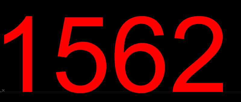

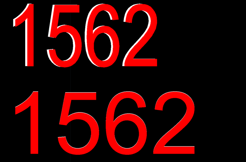

  7. It does move very slightly in my AutoCAD if Width is 1 and then only vertically. You might also look into line space style on the MText after Txt2Mtxt I set to exact and it lined up. Not sure about ZWCAD.
    1 point
  8. Had another look at this one, if you entmake the mtext using the text as a basis, it will shift in a similar way to txt2mtxt command. The insert points are still the same as in your example but it is as if there is a border around dtext that isn't there in mtext. Might have to accept that this is still a bit buggy to get them lined up exactly. Test code but noting the new mtext in this retains the width of the text style - would need to add a bit more to adjust that to the original taxt width (defun c:test ( / MyEnt ) ;; Get entity data (setq MyEnt (car (entsel "Select Text"))) ;; Select Entity (setq MyEntHJust (cdr (assoc 72 (entget MyEnt)))) ;; Get H Justification (setq MyEntVJust (cdr (assoc 73 (entget MyEnt)))) ;; Get V Justification ;;Get justification codes (if (= MyEntHJust 0)(setq JU 1)) (if (= MyEntHJust 1)(setq JU 2)) (if (= MyEntHJust 2)(setq JU 3)) (if (= MyEntHJust 3)(setq JU 1)) (if (= MyEntVJust 0)(setq JU (+ JU 6))) (if (= MyEntVJust 1)(setq JU (+ JU 6))) (if (= MyEntVJust 2)(setq JU (+ JU 3))) (if (= MyEntVJust 3)(setq JU (strcat JU 0))) ;; Create mtext (entmake (list '(0 . "MTEXT") '(100 . "AcDbEntity") (assoc 410 (entget MyEnt)) ;; space (assoc 8 (entget MyEnt)) ;; layer (if (= (assoc 62 (entget MyEnt)) nil)(cons 62 256) (assoc 62 (entget MyEnt)) ) '(100 . "AcDbMText") (assoc 10 (entget MyEnt)) ;; insert point (assoc 40 (entget MyEnt)) ;; text height (cons 71 JU) ;; attachment point, 0-9 '(72 . 5) (assoc 1 (entget MyEnt)) ;; text value (assoc 7 (entget MyEnt)) ;; text style (assoc 41 (entget MyEnt)) ;; Width (cons 42 (cdr (assoc 41 (entget MyEnt)))) ;; text width (assoc 50 (entget MyEnt)) ;; rotation '(73 . 1) ;; line spacing '(44 . 1.0) ;; line spacing factor )) (princ) )
