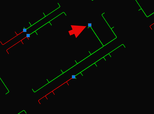

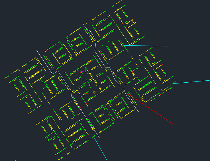

  3. @Engineer_Yasser Some of your linework is not drawn as tight as your first example. Look at the start point of this polyline in relation to your block insertion point. To 'fix' my code up the variable 'fz' to something like 2. In the scenario where the block is located on an end does it still pick a route since they are both on the same side? I'm curious, what are these drawings used for? Test 2-FZ=2.dwg
