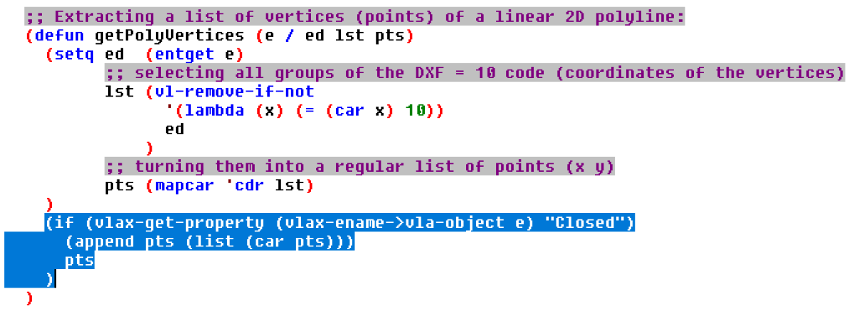

  2. The problem is in the 'getPolyVertices' function. When it comes to a closed polyline, it does not add the final closing point. For this reason, 'comprobar_centralidad' does not work correctly. Adjust the function as I show you in the image
