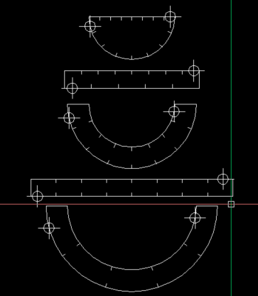

  4. Hi I've never experimented with the 'divide' command before. Or at least I don't remember when I last did. So I've been inspired by Bigal's code idea to make a slightly different version. In my case, 'divide' always makes the marks on the left side of the lines and inside the arcs. For this reason I decided to write some code to enable, in any case, the usefulness of this command. I'm leaving it here, in case it's useful to you. (defun c:tics (/ ent ptS creaBlq ptDir creaBlq entUlt ang angBase lstent borraCodigos tipObj entUlt comprbaLado) (defun creaBlq (nombre) (entmake (list (cons 0 "BLOCK") '(10 0.0 0.0 0.0) (cons 2 nombre) '(70 . 0))) (entmake '((0 . "LINE") (8 . "0") (10 0.0 0.0 0.0) (11 0.0 3.0 0.0))) (entmake (list (cons 0 "ENDBLK") (cons 8 "0"))) ) (defun borraCodigos (lstCodigos lstent / lst lst1) (foreach lst lstent (if (not (member (car lst) lstCodigos)) (setq lst1 (append lst1 (list lst))) ) ) lst1 ) (defun comprbaLado (lstEntobjBase / ent lstent lstEnts ptCen invertir?) (while (not (equal (setq ent (entlast)) entUlt)) (setq lstEnts (append lstEnts (list (vl-remove-if-not (function (lambda (x) (member (car x) '(0 8 2 10 11 40 50)))) (entget ent))))) (entdel ent) ) (foreach lst lstEnts (entmake (subst (cons 50 (+ (cdr (assoc 50 lst)) pi)) (assoc 50 lst) lst)) ) ) (if (not (tblsearch "BLOCK" "Muesca")) (creaBlq "Muesca") ) (while (setq ent (entsel "\nPick object near left end press Enter to exit ") ) (setq ptS (cadr ent) ent (car ent)) (setq ptDir (getpoint ptS "\nSelect the side on which to act...")) (if (= (setq tipObj (cdr (assoc 0 (setq lstent (entget ent))))) "LINE") (if (and (> (setq ang (angle ptDir (cdr (assoc 11 lstent)))) (setq angBase (angle (cdr (assoc 10 lstent)) (cdr (assoc 11 lstent)) ) ) ) (< ang (+ angBase pi)) ) (progn (entmod (append (borraCodigos '(10 11) lstent) (list (cons 10 (cdr (assoc 11 lstent))) (cons 11 (cdr (assoc 10 lstent)))) ) ) ) ) ) (setq entUlt (entlast)) (command "_divide" ent "_B" "Muesca" "_Y" (getint "Howmany tics ") ) (if (member tipObj '("ARC" "CIRCLE")) (if (> (distance ptDir (setq ptCen (cdr (assoc 10 lstent)))) (setq radio (cdr (assoc 40 lstent)))); es decir, si el lado seleccionado es el exterior (comprbaLado lstent) ) ) ) (princ) )

  11. Ok thought they were plines so much easier to solve just pick left side this gives a direction of the line or arc so added tick goes in correct direction. Bit busy at the moment. You can not auto solve as it depends on the direction of the objects wether it goes left or right. You can though use divide and a block, which is the approach I will use. Ok this is a crude way to do the task. Note I made a Block called "Ticker" it was a 2 unit long line drawn vertically from 0,0 with insertion point 0,0. (defun c:tics ( / ent pt3 start end d1 d2) (while (setq ent (entsel "\nPick object near left end press Enter to exit ")) (setq pt3 (cadr ent)) (setq cent (car ent)) (setq obj (vlax-ename->vla-object cent)) (setq start (vlax-curve-getstartPoint obj)) (setq end (vlax-curve-getEndPoint obj)) (setq d1 (distance pt3 end)) (setq d2 (distance pt3 start)) (if (< d1 d2) (progn (command "pedit" cent "r" "") (command "explode"(entlast) "") ) ) (command "divide" pt3 "B" "Ticker" "Y" (getint "Howmany tics ")) ) (princ) ) Look at image the 2 points to pick to have tics go in. They need left corner even when looking upside down. I can add the number of tics so that is not asked repeatedly. Change the size of the tics to what you want. The use of Pedit Reverse is because Bricscad does not have a "Reverse" command.
