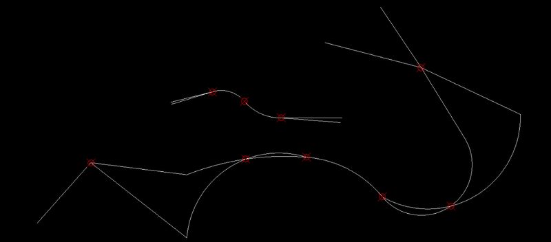

  6. i see what you were pointing at Danielm103.... the best i think is to mark the overlapping portions with points for now whit this code... Trying to Trace the Path of the Overlaping portion with a new polyline would be more like it... (defun c:MarkOverlap (/ ss plines layerName overlapLayer pline1 pline2 intPoints ptCount pt) ;; Prompt user to select polylines (setq ss (ssget '((0 . "LWPOLYLINE")))) (if (not ss) (progn (alert "No polylines selected. Exiting.") (exit) ) ) ;; Debugging: Print the number of polylines selected (princ (strcat "\nNumber of polylines selected: " (itoa (sslength ss)))) ;; Create a new layer for overlap points (setq layerName "OverlapPoints") (setq overlapLayer (tblsearch "LAYER" layerName)) (if (not overlapLayer) (progn (command "._-LAYER" "_M" layerName "_C" "1" layerName "") (princ (strcat "\nNew layer created: " layerName)) ) (princ (strcat "\nLayer already exists: " layerName)) ) ;; Set the new layer as current (setvar "CLAYER" layerName) (princ (strcat "\nCurrent layer set to: " layerName)) ;; Convert selection set to a list of polylines (setq plines '()) (setq index 0) (repeat (sslength ss) (setq pline (ssname ss index)) (setq plines (cons pline plines)) (setq index (1+ index)) ) (setq plines (reverse plines)) ;; Reverse to maintain original order (princ (strcat "\nNumber of polylines processed: " (itoa (length plines)))) ;; Initialize point counter (setq ptCount 0) ;; Iterate through all pairs of polylines (foreach pline1 plines (foreach pline2 plines (if (not (eq pline1 pline2)) (progn ;; Debugging: Print the handles of the polylines being compared (princ (strcat "\nComparing polyline 1 (Handle: " (vlax-get (vlax-ename->vla-object pline1) 'Handle) ")")) (princ (strcat "\nComparing polyline 2 (Handle: " (vlax-get (vlax-ename->vla-object pline2) 'Handle) ")")) ;; Find intersection points (setq intPoints (vlax-invoke (vlax-ename->vla-object pline1) 'IntersectWith (vlax-ename->vla-object pline2) acExtendNone)) (if intPoints (progn ;; Debugging: Print the number of intersection points found (princ (strcat "\nIntersection points found: " (itoa (/ (length intPoints) 3)))) ;; Process intersection points (setq i 0) (while (< i (length intPoints)) (setq pt (list (nth i intPoints) (nth (1+ i) intPoints) (nth (+ 2 i) intPoints))) (command "._POINT" pt) (setq ptCount (1+ ptCount)) ;; Increment point counter (setq i (+ i 3)) ;; Move to the next set of coordinates ) ) (princ "\nNo intersection points found.") ) ) ) ) ) ;; Debugging: Print the total number of points created (princ (strcat "\nTotal points created: " (itoa ptCount))) ;; Reset to the previous layer (setvar "CLAYER" (getvar "CLAYER")) (princ "\nOverlap locations marked with points on layer 'OverlapPoints'.") (princ) ) curve.dwg

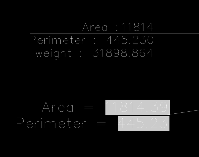

  11. "With the calculation of weight, it becomes more complicated." Fields can have formulas so you can get area and * weight.
    1 point
  12. Bonjour @GLAVCVS Yes, it is the case, but the fields are only interesting when it is possible to modify the entity and therefore change the value of the field. With the calculation of weight, it becomes more complicated. So I made the choice to work with text and not with fields. Because regions are not entities that can be easily modified. I am waiting for the answer of @anouar He will say whether it is correct or not. Amicalement
    1 point
  13. In Anouar's code, numerical calculations are shown in highlighting. If this is important, you may need to change something in your code.
    1 point
  14. Bonjour @GLAVCVS I don't understand your message. Where is the "small" problem ? Have you read my solution? If this is the case, you understand that this line I correct is part of a general (setq) Amicalement
    1 point
  15. Bonjour @anouar I don't know if you are interested in my proposition, but it is certain I made a mistake in. I forgot to divide by 1000 for the calculation of the weight. Are you able to fix the problem ? Or do you need help ? Amicalement
    1 point
  16. Let's see. I don't quite understand what you need. Let me see if I get it right: do you need a few more lines of text where "Weight = [result of: (area * 2.7) / 1000]" appears?
    1 point
  17. Bonjour @anouar Here is what I propose Amicalement Anouar-CadTutor.lsp
