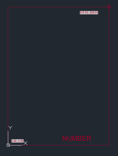

  2. Hey @Nikon, If I can give you some advice. I had the same situation about 2-3 years ago, and I've been thinking about how to do automatization in creating layouts. And, I figure it out the best way (for my purpose) is to make differents "dwg" with appropriate size of viewports with accompanying "dwt" files (where are you going to have a "block" section with the name of company, number of project, name of the project, etc.). The first one is to make a different sizes of desired viewports. This one from picture 1 is for the 297x420 cm paper size. The second one is to make a "dwt" files where are you going to put your viewport inside the layout. The picture 2 show how it looks layout for the paper size 297x420 cm. The third one is coding (this is the first time when I created something using autolisp, the first program). It will look like this (this is the part from the code): (while (< i len) (setq base nil) (setq xy nil) (setq obj (ssname ss i)) (setq data1 (entget (ssname ss i))) (setq blockname (cdr (assoc 2 data1))) (cond ((= blockname L1) (setq data2 (entget (entnext (cdr (assoc -1 data1))))) (setq data3 (entget (entnext (cdr (assoc -1 data2))))) (setq data4 (entget (entnext(cdr (assoc -1 data3))))) (setq base (cdr (assoc 11 data3))) (setq xy (cdr (assoc 1 data3))) (setq no (1+ i)) (setq data4 (subst (cons 1 (itoa no)) (assoc 1 data4) data4)) (entmod data4) (setq nno (strcat v1 "." v2 "." (itoa no))) (setq path (findfile ".\\Situacioni plan saobracajne signalizacije_297x420.dwt")) (command "layout" "t" path "1") (command "layout" "s" "1") (command "layout" "r" "" nno) (command "mspace" "ucs" "ob" obj "plan" "c" "zoom" "w" base xy "pspace") ) ................... I hope I gave you some idea, it is simillar as @BIGAL proposal. Best regards.
