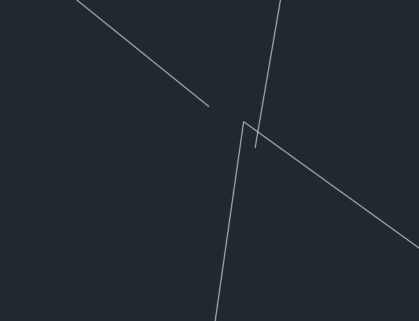

  9. I found the opposite a overshoot that should be fixed to. Another but ugly
    1 point
