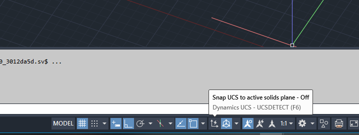

  15. @vindicate Turnoff the Dynamic UCS and apply @Cad64 approach using construction line.

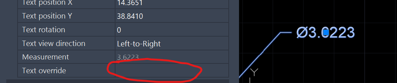

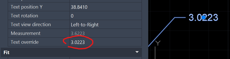

  16. Enter the diameter value in the Text overide box of the properties panel. Note that the dimension will no longer be associative.

  17. Can you not just click on the dim and in properties just remove the %%d or the dia symbol. You can overwrite any dim, if you replace the text with <> it should revert back to the actual distance.

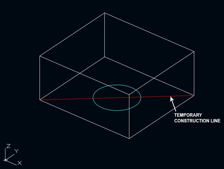

  18. One way to do this would be to draw a temporary construction line from endpoint to endpoint. Then you can draw a circle at the midpoint of that line and then delete the line. Also, working in 2D wireframe mode, instead of Xray mode, makes it easier to work without the faces getting in the way.
