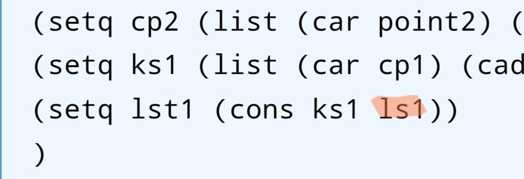

  1. Welcome to the forum! I know it doesn't seem important when you start programming, but indenting will help you find errors. One missing parenthesis can throw off your whole function.
    1 point
  2. Hi @Greenland Maybe you should just change the 'ls1' shown in the image to 'lst1'
