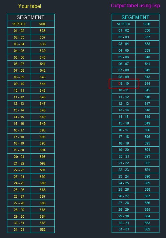

  1. Hi @leo321, I'v been played with this and made: ; ************************************************************************************* ; Functions : TXTBL ; Subfunctions : - ; Description : Put the TEXT or MTEXT values into the tabel in model space ; Author : SAXLLE ; Date : April 03, 2025 ; ************************************************************************************* (prompt "\nTo run a LISP type: TXTBL") (princ) (defun c:TXTBL ( / header first_column second_column ent ptlist len i pt_num pt_num_lst def_len len_pt_num_lst output_vertex output_text_val dist ang npt_one angn npt_second ss ssn len_ss j dist_pos_ent_name_lst n ent_ssn ptlist_ssn ss_new text_val_pos dist_pos dist_pos_ent_name dist_pos_ent_name_lst vertex text_val acadObj doc pt numRows numColumns rowHeight colWidth txtHeightHeader txtHeightColumns row col modelSpace myTable) (setq header "SEGEMENT" first_column "VERTEX" second_column "SIDE" ) (prompt "\nSelect the GREEN Polyline:") (setq ent (ssget '((0 . "LINE,LWPOLYLINE") (8 . "LIXO") (62 . 3)))) (setq ptlist (mapcar 'cdr (vl-remove-if-not '(lambda (x) (= (car x) 10)) (entget (ssname ent 0)))) len (length ptlist) i 1 ) (foreach n ptlist (setq pt_num (cons i n) pt_num_lst (cons pt_num pt_num_lst) ) (setq i (1+ i)) ) (setq pt_num_lst (reverse pt_num_lst)) (setq def_len 250 len_pt_num_lst (length pt_num_lst) i 0 output_vertex (list) output_text_val (list) ) (while (< i len_pt_num_lst) ;; start main if (if (not (equal (1+ i) len_pt_num_lst)) ;; start main progn (progn (setq dist (/ (distance (cdr (nth i pt_num_lst)) (cdr (nth (1+ i) pt_num_lst))) 2) ang (angle (cdr (nth i pt_num_lst)) (cdr (nth (1+ i) pt_num_lst))) npt_one (polar (cdr (nth i pt_num_lst)) ang dist) angn (+ ang (/ pi 2)) npt_second (polar npt_one angn def_len) ) (setq ss (ssget "_F" (list npt_one npt_second) '((0 . "TEXT,MTEXT") (8 . "LOTE")))) ;; start cond (cond ;; 1. cond ((equal ss nil) (setq ssn (ssget "_F" (list npt_one npt_second) '((0 . "LWPOLYLINE") (8 . "LOTE"))) len_ss (sslength ssn) j 0 dist_pos_ent_name_lst (list) n (1- len_ss) ) (repeat len_ss ;; start if (if (not (equal n -1)) ;; start progn (progn (setq ent_ssn (entget (ssname ssn n)) ptlist_ssn (mapcar 'cdr (vl-remove-if-not '(lambda (x) (= (car x) 10)) ent_ssn)) ss_new (ssget "_WP" ptlist_ssn '((0 . "TEXT,MTEXT") (8 . "LOTE"))) text_val_pos (cdr (assoc 10 (entget (ssname ss_new j)))) dist_pos (distance npt_one text_val_pos) dist_pos_ent_name (list dist_pos (ssname ss_new j)) dist_pos_ent_name_lst (cons dist_pos_ent_name dist_pos_ent_name_lst) n (1- n) ) ) ;; end progn ) ;; end if ) ;; end repeat (setq dist_pos_ent_name_lst (vl-sort dist_pos_ent_name_lst (function (lambda (x1 x2) (< (car x1) (car x2)))))) ;; Sorting list from MIN to MAX Distance with entity (if (and (< (1+ i) 10) (< (+ i 2) 10)) (setq vertex (strcat "0" (itoa (1+ i)) " - " "0" (itoa (+ i 2))) text_val (cdr (assoc 1 (entget (car (cdr (nth j dist_pos_ent_name_lst)))))) output_vertex (cons vertex output_vertex) output_text_val (cons text_val output_text_val) ) (setq vertex (strcat (itoa (1+ i)) " - " (itoa (+ i 2))) text_val (cdr (assoc 1 (entget (car (cdr (nth j dist_pos_ent_name_lst)))))) output_vertex (cons vertex output_vertex) output_text_val (cons text_val output_text_val) ) ) ) ;; end 1. cond ;; 2. cond ((not (equal ss nil)) (if (and (< (1+ i) 10) (< (+ i 2) 10)) (setq vertex (strcat "0" (itoa (1+ i)) " - " "0" (itoa (+ i 2))) text_val (cdr (assoc 1 (entget (ssname ss 0)))) output_vertex (cons vertex output_vertex) output_text_val (cons text_val output_text_val) ) (setq vertex (strcat (itoa (1+ i)) " - " (itoa (+ i 2))) text_val (cdr (assoc 1 (entget (ssname ss 0)))) output_vertex (cons vertex output_vertex) output_text_val (cons text_val output_text_val) ) ) ) ;; end 2. cond ) ;; end cond ) ;; end main progn ) ;; end main if (setq i (1+ i)) ) ;; end while (setq last_i (1- i) i 0) ;; start repeat (repeat (1+ i) (setq dist (/ (distance (cdr (nth i pt_num_lst)) (cdr (nth last_i pt_num_lst))) 2) ang (angle (cdr (nth last_i pt_num_lst)) (cdr (nth i pt_num_lst))) npt_one (polar (cdr (nth last_i pt_num_lst)) ang dist) angn (+ ang (/ pi 2)) npt_second (polar npt_one angn def_len) ) (setq ss (ssget "_F" (list npt_one npt_second) '((0 . "TEXT,MTEXT") (8 . "LOTE")))) ;; start cond (cond ;; 1. cond ((equal ss nil) (setq ssn (ssget "_F" (list npt_one npt_second) '((0 . "LWPOLYLINE") (8 . "LOTE"))) len_ss (sslength ssn) j 0 dist_pos_ent_name_lst (list) n (1- len_ss) ) (repeat len_ss ;; start if (if (not (equal n -1)) ;; start progn (progn (setq ent_ssn (entget (ssname ssn n)) ptlist_ssn (mapcar 'cdr (vl-remove-if-not '(lambda (x) (= (car x) 10)) ent_ssn)) ss_new (ssget "_WP" ptlist_ssn '((0 . "TEXT,MTEXT") (8 . "LOTE"))) text_val_pos (cdr (assoc 10 (entget (ssname ss_new j)))) dist_pos (distance npt_one text_val_pos) dist_pos_ent_name (list dist_pos (ssname ss_new j)) dist_pos_ent_name_lst (cons dist_pos_ent_name dist_pos_ent_name_lst) n (1- n) ) ) ;; end progn ) ;; end if ) ;; end repeat (setq dist_pos_ent_name_lst (vl-sort dist_pos_ent_name_lst (function (lambda (x1 x2) (< (car x1) (car x2)))))) ;; Sorting list from MIN to MAX Distance with entity (setq vertex (strcat (itoa (+ last_i 1)) " - " "0" (itoa (+ i 1))) text_val (cdr (assoc 1 (entget (car (cdr (nth j dist_pos_ent_name_lst)))))) output_vertex (cons vertex output_vertex) output_text_val (cons text_val output_text_val) ) ) ;; end 1. cond ;; 2. cond ((not (equal ss nil)) (setq vertex (strcat (itoa (+ last_i 1)) " - " "0" (itoa (+ i 1))) text_val (cdr (assoc 1 (entget (ssname ss 0)))) output_vertex (cons vertex output_vertex) output_text_val (cons text_val output_text_val) ) ) ;; end 2. cond ) ;; end cond ) ;; end repeat (setq output_vertex (reverse output_vertex)) (setq output_text_val (reverse output_text_val)) (setq acadObj (vlax-get-acad-object) doc (vla-get-ActiveDocument acadObj) ) (if (= 1 (getvar 'cvport)) (setvar 'ctab "MODEL") ) (setq pt (vlax-3d-point (getpoint "\nPick the insertation point for Table:")) numRows (+ (length output_vertex) 2) numColumns 2 rowHeight 14.00 colWidth 100.0 txtHeightHeader 7.50 txtHeightColumns 5.00 row 0 col 0 ) (setq modelSpace (vla-get-ModelSpace doc)) ;; Add a Header to Table (setq myTable (vla-Addtable modelSpace pt numRows numColumns rowHeight colWidth)) ;; Put the color of the tabel into the Cyan (vla-put-Color myTable acCyan) (vla-SetTextHeight2 myTable row col row txtHeightHeader) (vla-SetColumnWidth myTable col colWidth) (vla-SetText myTable row col header) ;; Add a Header to 1. column (vla-SetTextHeight2 myTable (1+ row) col (1+ row) txtHeightColumns) (vla-SetColumnWidth myTable col (/ colWidth 2)) (vla-SetText myTable (1+ row) col first_column) ;; Add a Header to 2. column (vla-SetTextHeight2 myTable (1+ row) (1+ col) (1+ row) txtHeightColumns) (vla-SetColumnWidth myTable (1+ col) (/ colWidth 2)) (vla-SetText myTable (1+ row) (1+ col) second_column) ;; Iterate trought the "output_vertex" and add a value to every row at 1. column ;; while start (while (< row (length output_vertex)) ;; start if (if (<= (1+ row) (length output_vertex)) ;; progn start (progn (vla-SetTextHeight2 myTable (+ row 2) col (+ row 2) txtHeightColumns) (vla-SetCellAlignment myTable (+ row 2) col acMiddleCenter) (vla-SetText myTable (+ row 2) col (nth row output_vertex)) ) ;; progn end ) ;; if end (setq row (1+ row)) ) ;; end while (setq row 0) ;; Reset the row number (setq col (1+ col)) ;; Go into the another column ;; Iterate trought the "output_text_val" and add a value to every row at 2. column ;; while start (while (< row (length output_text_val)) ;; start if (if (<= (1+ row) (length output_text_val)) ;; progn start (progn (vla-SetTextHeight2 myTable (+ row 2) col (+ row 2) txtHeightColumns) (vla-SetCellAlignment myTable (+ row 2) col acMiddleCenter) (vla-SetText myTable (+ row 2) col (nth row output_text_val)) ) ;; progn end ) ;; if end (setq row (1+ row)) ) ;; end while (prompt "\nThe Tabel with values is inserted in model space!") (princ) ) As you can see on the picture from belowed, the "output tabel using lisp" is what I get using lisp from above, but there is one thing, when formatting "VERTEX" column, I get "9 - 10" insted of "09 - 10" (you can see the red rectangle). Also, it isn't formatted as yours "Your tabel" from picture (I'm not yet familiar with all things about the Tabel formatting, sorry ). I didn't mention, I use this for "ssget" filter '((0 . "LINE,LWPOLYLINE") (8 . "LIXO") (62 . 3)))), '((0 . "TEXT,MTEXT") (8 . "LOTE")) and '((0 . "LWPOLYLINE") (8 . "LOTE")), if you have different layers names/colors, it wont work. I hope it will helpful for your purpose. If you have maybe larger drawing, please upload it, just for the test. Best regards.
