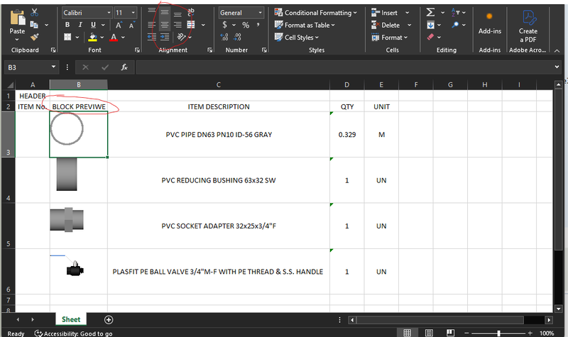

  1. from pyrx import Rx, Ge, Gi, Gs, Db, Ap, Ed, Ax import traceback import wx # wxPython import openpyxl as xl from openpyxl.drawing.image import Image as xlImage from openpyxl.utils.cell import get_column_letter @Ap.Command() def doit(): try: db = Db.curDb() ps, id, _ = Ed.Editor.entSel("\nSelect a table: ", Db.Table.desc()) if ps != Ed.PromptStatus.eOk: raise RuntimeError("Selection Error! {}: ".format(ps)) wb = xl.Workbook() ws = wb.active table = Db.Table(id) opts = Db.TableIteratorOption.kTableIteratorSkipMerged for cell in table.cells(opts): if table.cellType(cell.row, cell.column) == Db.CellType.kBlockCell: blk = table.blockTableRecordId(cell.row, cell.column) img: wx.Image = Gs.Core.getBlockImage(blk, 64, 64, 1.0, [0, 0, 0]) img.SetMaskColour(0, 0, 0) img.SetMask(True) imgpath = "E:\\temp\\Icons\\{}.png".format(blk.handle()) img.SaveFile(imgpath, wx.BITMAP_TYPE_PNG) xlimg = xlImage(imgpath) xlimg.width = 64 xlimg.height = 64 cellref = "{}{}".format(get_column_letter(cell.column + 1), cell.row + 1) ws.add_image(xlimg, cellref) else: ws.cell( row=cell.row + 1, column=cell.column + 1, value=table.textString(cell.row, cell.column), ) wb.save("E:\\temp\\logo.xlsx") except Exception as err: traceback.print_exception(err)
    1 point
  2. I was only centering the image, this version does all the modified cells You can use AcDbDatabase.getFilename to get the path, then use python’s pathlib (built in) to play with paths from pyrx import Rx, Ge, Gi, Gs, Db, Ap, Ed, Ax import traceback from openpyxl.drawing.image import Image as xlImage from openpyxl.utils.cell import get_column_letter from openpyxl.styles import Alignment import openpyxl as xl import pathlib import wx @Ap.Command() def doit(): try: db = Db.curDb() ps, id, _ = Ed.Editor.entSel("\nSelect a table: ", Db.Table.desc()) if ps != Ed.PromptStatus.eOk: raise RuntimeError("Selection Error! {}: ".format(ps)) #paths xlpath = pathlib.Path(db.getFilename()).parent xlname = pathlib.Path(db.getFilename()).stem wb = xl.Workbook() ws = wb.active table = Db.Table(id) opts = Db.TableIteratorOption.kTableIteratorSkipMerged for cell in table.cells(opts): # format all cells currentCell = ws.cell(cell.row + 1, cell.column + 1) currentCell.alignment = Alignment(horizontal="center", vertical="center") if table.cellType(cell.row, cell.column) == Db.CellType.kBlockCell: blk = table.blockTableRecordId(cell.row, cell.column) img: wx.Image = Gs.Core.getBlockImage(blk, 64, 64, 1.0, [0, 0, 0]) img.SetMaskColour(0, 0, 0) img.SetMask(True) imgpath = "{}/{}.png".format(xlpath, blk.handle()) img.SaveFile(imgpath, wx.BITMAP_TYPE_PNG) xlimg = xlImage(imgpath) xlimg.width = 64 xlimg.height = 64 cellref = "{}{}".format(get_column_letter(cell.column + 1), cell.row + 1) ws.add_image(xlimg, cellref) ws.row_dimensions[cell.row + 1].height = 64 else: ws.cell( row=cell.row + 1, column=cell.column + 1, value=table.textString(cell.row, cell.column), ) wb.save("{}/{}.xlsx".format(xlpath, xlname)) except Exception as err: traceback.print_exception(err) apparently xl has weirdness when it comes to images and alignment with regards to aspect ratio.
    1 point
  3. also, you can change the icon size #id width, height, zoom, RGB img: wx.Image = Gs.Core.getBlockImage(id, 64, 64, 1.0, [0, 0, 0]) could be 128 128, you'll need to change the cell size to match
    1 point
  4. add alignment from pyrx import Rx, Ge, Gi, Gs, Db, Ap, Ed, Ax import traceback import wx # wxPython import openpyxl as xl from openpyxl.drawing.image import Image as xlImage from openpyxl.utils.cell import get_column_letter from openpyxl.styles import Alignment #--------------------- @Ap.Command() def doit(): try: db = Db.curDb() ps, id, _ = Ed.Editor.entSel("\nSelect a table: ", Db.Table.desc()) if ps != Ed.PromptStatus.eOk: raise RuntimeError("Selection Error! {}: ".format(ps)) wb = xl.Workbook() ws = wb.active table = Db.Table(id) opts = Db.TableIteratorOption.kTableIteratorSkipMerged for cell in table.cells(opts): if table.cellType(cell.row, cell.column) == Db.CellType.kBlockCell: blk = table.blockTableRecordId(cell.row, cell.column) img: wx.Image = Gs.Core.getBlockImage(blk, 64, 64, 1.0, [0, 0, 0]) img.SetMaskColour(0, 0, 0) img.SetMask(True) imgpath = "E:\\temp\\Icons\\{}.png".format(blk.handle()) img.SaveFile(imgpath, wx.BITMAP_TYPE_PNG) xlimg = xlImage(imgpath) xlimg.width = 64 xlimg.height = 64 cellref = "{}{}".format(get_column_letter(cell.column + 1), cell.row + 1) ws.add_image(xlimg, cellref) ws.row_dimensions[ cell.row + 1].height = 60 currentCell = ws.cell(cell.row + 1,cell.column + 1)#--------------------- currentCell.alignment = Alignment(horizontal='center',vertical='center')#--------------------- else: ws.cell( row=cell.row + 1, column=cell.column + 1, value=table.textString(cell.row, cell.column), ) wb.save("E:\\temp\\logo.xlsx") except Exception as err: traceback.print_exception(err)
    1 point
  5. Replace AppData\Programs\Python\Python312\Lib\site-packages\pyrx\ PyRxV25.0.brx with this set the current shademode to realistic before running doit
    1 point
  6. ignore.... changed the path in the code
    1 point
  7. I also noticed I had a BricsCAD support request SR 180584 AcGsView::getSnapShot does not pickup shademode, so the icons will come out wireframe. But, I made a work around.. I'll make a build
    1 point
  8. Sorry, I noticed your running BricsCAD 2021? If so, I’m sorry to say only v24-v25 is supported. Or maybe you forgot to update your profile? 1, head over to https://github.com/CEXT-Dan/PyRx?tab=readme-ov-file#installation and have look at the project 2, Download and install 3.12.10 x64 from https://www.python.org/downloads/windows/ (all users is NOT checked, and PATH is checked) 3, Open up PowerShell and type “pip install cad-pyrx” without the quotes. 4, in BricsCAD, type “appload”, navigate to: “AppData\Programs\Python\Python312\Lib\site-packages\pyrx\RxLoaderV25.0.brx” 5, Make sure it’s loaded, type “pyload” at the bricscad prompt 6, if the load dialog box shows, then were successful so far 7, close bricscad 8, back in powershell type “pip install openpyxl” , this will install the excel library. 9, copy paste the sample code above into a file into a text file, “myfirstmodule.py” 10, using a text editor, edit the paths in the sample, maybe rename the “doit” command 11, open BricsCAD, type in “pyload”, load your module, run your new command If you get this far, you might want to grab a python editor like VsCode and install the python plugins
    1 point
