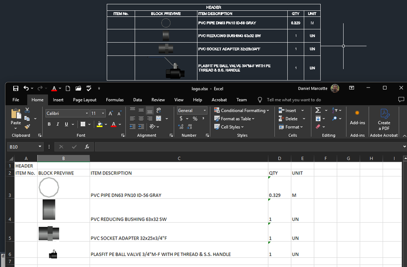

  2. from pyrx import Rx, Ge, Gi, Gs, Db, Ap, Ed, Ax import traceback import wx # wxPython import openpyxl as xl from openpyxl.drawing.image import Image as xlImage from openpyxl.utils.cell import get_column_letter @Ap.Command() def doit(): try: db = Db.curDb() ps, id, _ = Ed.Editor.entSel("\nSelect a table: ", Db.Table.desc()) if ps != Ed.PromptStatus.eOk: raise RuntimeError("Selection Error! {}: ".format(ps)) wb = xl.Workbook() ws = wb.active table = Db.Table(id) opts = Db.TableIteratorOption.kTableIteratorSkipMerged for cell in table.cells(opts): if table.cellType(cell.row, cell.column) == Db.CellType.kBlockCell: blk = table.blockTableRecordId(cell.row, cell.column) img: wx.Image = Gs.Core.getBlockImage(blk, 64, 64, 1.0, [0, 0, 0]) img.SetMaskColour(0, 0, 0) img.SetMask(True) imgpath = "E:\\temp\\Icons\\{}.png".format(blk.handle()) img.SaveFile(imgpath, wx.BITMAP_TYPE_PNG) xlimg = xlImage(imgpath) xlimg.width = 64 xlimg.height = 64 cellref = "{}{}".format(get_column_letter(cell.column + 1), cell.row + 1) ws.add_image(xlimg, cellref) else: ws.cell( row=cell.row + 1, column=cell.column + 1, value=table.textString(cell.row, cell.column), ) wb.save("E:\\temp\\logo.xlsx") except Exception as err: traceback.print_exception(err)

  5. O.K....... forgot about it... I changed the py function file name but didn't changed it in "loadPythonModule" string ... now it is this way with the correct file name (Py_tablewithimagetoexcel.py): from pyrx import Ap Ap.Application.loadPythonModule("C:\\Users\\Aridzv\\AppData\\Roaming\\Bricsys\\BricsCAD\\Lsp\\Python\\Py_tablewithimagetoexcel.py") now it's working and no need for the calls from "on_start.lsp" and "on_doc_load.lsp" . thanks!!
    1 point
  6. "on_start.lsp" and "on_doc_load.lsp" may load in to BricsCAD at a different time then PyRx. If it’s loaded before PyRx, there is no pyload command It’s why pyrx_onload.py was created But if what you have is working for you, then, yay

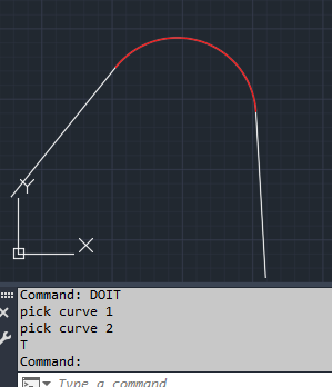

  8. maybe a useful example, check if two curves overlap the lisp: (defun c:doit (/ c1 c2) (setq c1 (car (entsel "pick curve 1\n"))) (setq c2 (car (entsel "pick curve 2\n"))) (check_overlap c1 c2) ) the python from pyrx import Rx, Ge, Gi, Gs, Db, Ap, Ed, Ax import traceback @Ap.LispFunction() def check_overlap(resbuf): try: cv1 = None cv2 = None # check the resbuf if len(resbuf) != 2: return None if resbuf[0][0] != Rx.LispType.kObjectId: return None if resbuf[1][0] != Rx.LispType.kObjectId: return None # get the geometry dbc1 = Db.Curve(resbuf[0][1]) cv1 = dbc1.getAcGeCurve() dbc2 = Db.Curve(resbuf[1][1]) cv2 = dbc2.getAcGeCurve() # do the check cc = Ge.CurveCurveInt3d(cv1, cv2) return cc.overlapCount() > 0 except Exception as err: traceback.print_exception(err) and the results
