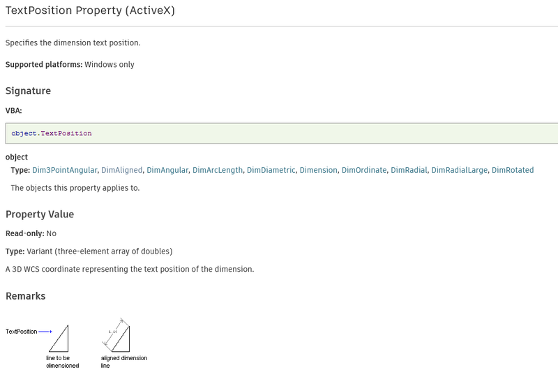

  4. The problem is that there's no DXF code 147 to control the text gap. That's controlled directly from the coordinate associated with code 11. From VLA, you can control the gap using the "TextGap" property.

  8. TRY https://help.autodesk.com/view/OARX/2022/ENU/?guid=GUID-E39FFEDE-FF81-4071-81E9-02D9C376D918
    1 point
