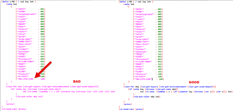

  5. change this : ("*EN-LITE-CIRC . 160) to this ("*EN-LITE-CIRC" . 160) and if you want to keep this line ERROR WTF MAYBE MAKE NEW SCRIPT ----------------------------------------------- LAYCOL add a ;; before the line as bigal pointed out ;;ERROR WTF MAYBE MAKE NEW SCRIPT ;;----------------------------------------------- ;;LAYCOL
    1 point
