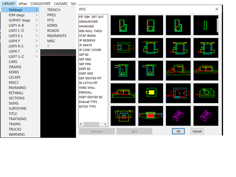

  5. Making a "pop" menu is easy you can make them using notepad. here is some sample code. You have a header section which names the menu, followed by menu options, you can have sub menus and image menus, also toolbar menu's. If you provide a list of lisp program names and the command name I can attempt to make you a mnu file. eg lispname = MYDOCIRC.lsp command DOCIRC ***MENUGROUP=STDS ***POP20 **CADLIB [->LISP1 A-B] [1/4 POINTS]^C^C(LOAD "1-4 POINTS") [Add 2 Level]^C^C(LOAD "add-to-levels") [Add-pits-drain]^C^C(LOAD"Add-pits-drain") [Allbylayer]^C^C(LOAD "Allbylayer") [Apndtext]^C^C^p(LOAD "apndtext") [Apparent int]^C^C^p(LOAD "apparent int") [Area-label]^C^C^p(LOAD "area-label")
