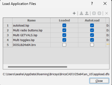

  5. In Bricscad you can use Appload and save a custom lisp containing all your shortcuts, yes use Autoload within that lisp, for me I use custom lisps rather than play with the default lisps, this works for Autocad as well, Appload add to Start up suite. Just a side comment did a post yesterday about making a Install.lsp to do just that and it is possible to find what the load on start up currently are, then add a new one. (setq ver (vl-registry-read "HKEY_CURRENT_USER\\Software\\Bricsys\\BricsCAD" "CURVER")) (setq val (strcat "HKEY_CURRENT_USER\\Software\\Bricsys\\BricsCAD\\" ver "\\en_US\\Profiles\\Default\\Config")) (setq suppath (vl-registry-read val "SRCHPATH"))

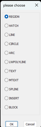

  6. @SLW210 just use the Multi radio buttons.lsp for the dcl. Just make sure Multi radio buttons.lsp is saved in a support path or add full path to the Load. (if (not AH:Butts)(load "Multi Radio buttons.lsp")) (setq ans (ah:butts 1 "v" '("please choose" "REGION" "HATCH" "LINE" "CIRCLE" "ARC" "LWPOLYLINE" "TEXT" "MTEXT" "SPLINE" "INSERT" "BLOCK"))) ; ans holds the button picked value Multi radio buttons.lsp
