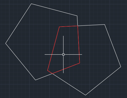

  2. from pyrx import Rx, Ge, Gi, Db, Ap, Ed import traceback from shapely import Polygon @Ap.Command() def doit(): try: db = Db.curDb() desc = Db.Polyline.desc() ps, id1, _ = Ed.Editor.entSel("\nPline1 :", desc) ps, id2, _ = Ed.Editor.entSel("\nPline2 :", desc) pline1 = Db.Polyline(id1) pline2 = Db.Polyline(id2) polygon1 = Polygon(pline1.toList()) polygon2 = Polygon(pline2.toList()) res = polygon1.intersection(polygon2) pl3 = Db.Polyline(list(res.exterior.coords)) pl3.setColorIndex(1) db.addToModelspace(pl3) print(res.area, pl3.getArea()) except Exception as err: traceback.print_exception(err)

  8. With shapely, you can make computations without the having the entities in the drawing. There are other calculations too https://shapely.readthedocs.io/en/stable/manual.html
